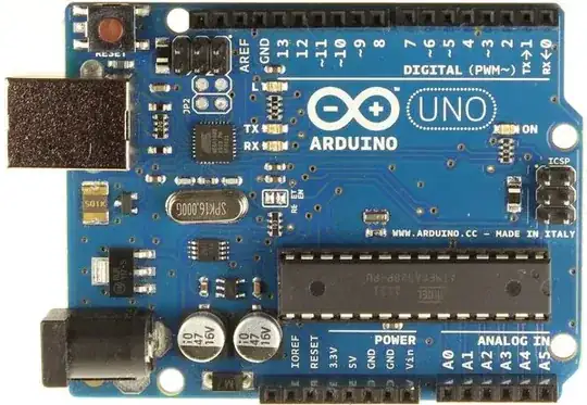

I have an Arduino board here and there is a pin called "GND", as i understand GND is stand for "Ground". . So there are 3 different concept that i need to learn : "Ground", "Earth", "AV Neutral" ?
So what is the voltage output of that GND pin ? Is it 0v ? What is the voltage output of "Earth" ? What is the voltage output of "AV Neutral" ?
'GND' is the circuit common, the datum, the reference node, or more colloquially, it's the node where you put the black lead of your voltmeter.
In other words, it is the node to which all other node voltages in the circuit are referenced.
It is not a voltage output. The 'GND' pin does not output 0V.
Think about it. If you want to measure the voltage on the 'GND' pin, you would put the red lead of your voltmeter on that pin. Where is the black lead connected? It's connected to the very same pin. So, with both leads of the voltmeter connected together, you read 0V.
When you connect a 5V power supply, the 5V is the voltage across the two power supply leads. When you connect the more negative lead to the 'GND' pin, and the more positive lead to the '5V' pin, you're placing 5V across those two points in the circuit.
Similarly for the 3.3V power supply.
