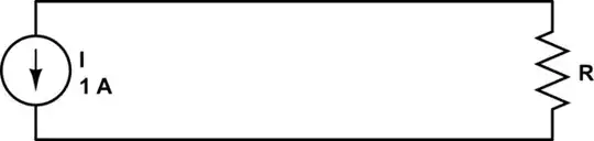

Intuition would tell us that if we could somehow connect the capacitors with a zero resistance, than the energy would be conserved. But this is wrong. Our intuition comes from the fact that usually power decreases as resistance approaches zero. For example:
schematic
$$P = 1A\cdot V\\ V = 1A\cdot R$$
Therefore, as \$R\to 0\Omega\$, then \$V\to0V\$. Clearly, \$1A\cdot 0V = 0W\$, so we can say:
$$\lim_{R \to 0} (1A)^2R = 0W$$
This is the usual case because although the circuits we make aren't just current sources, they have some resistance somewhere that limits the current. Thus, we are in the habit of thinking minimize unintentional resistance to minimize loss.

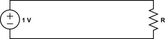

Another example:
schematic
simulate this circuit
$$ P = 1V \cdot I\\ I = 1V/R $$
Therefore, as \$R\to 0\Omega\$, then \$I\$ gets bigger, and then you hit a division by zero. Therefore, we can't evaluate the limit:
$$\lim_{R \to 0} \frac{(1V)^2}{R}$$
Now, consider that in the instant that you connect the capacitors, they look like voltage sources, and you can see that it's not possible to connect even ideal capacitors with ideal conductors. Even if you connect them with very small resistances, current goes up, \$I^2R\$ losses go through the roof, and you are no better off than had you connected them with a large resistance. There must necessarily be some sort of impedance between the capacitors for this circuit to be mathematically consistent: if it's not a resistance, then perhaps an inductance.
