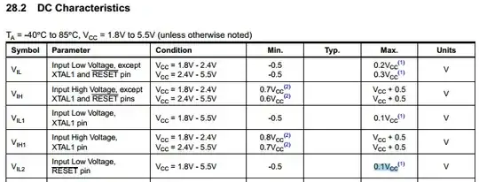

Most controllers define the maximum input low voltage around 0.5V. Look at the datasheet, in most cases this depends on the supply voltage. The controller on the Arduino nano is an ATmega328 if i am not mistaken. From the data sheet:
DC characteristics Take a look at the "Input low voltage, RESET pin". It states as max $$ 0,1 * Vcc $$
At Vcc = 5V this gives you $$ 0,1 * 5V = 0,5V $$ So everything below 0.5V on the Reset pin will trigger a reset.

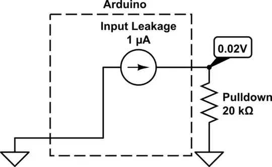

In this case, the chip would need to sink significant currents (100's of milliamps). Lets assume it is connected to an Arduino Uno input pin with a 20kilo-ohm pulldown resistor. The microcontroller in the Uno is an Atmega328, and in the datasheet it lists an input leakage of 1 micro-amp. This is the current that flows through the pulldown resistor to make the pins voltage go low - therefore, when nothing but the pulldown resistor is connected to the pin, the voltage at that pin would equal $$ V_{pin} = I_{leakage} \times R_{pullup} = 1\mu A \times 20k\Omega = 0.02V $$

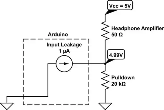

Now, lets connect the headphone amplifier. For simplicities sake we can model the headphone amplifier as a resistor of 50 ohms, this would cause 100mA to flow when connected to 5V.
schematic
simulate this circuit
The input resistance of the Uno is about 100 mega-ohm, so it's totally negligible. This means that the resistance of the amplifier would be effectively connected in series with the pulldown resistor. Now, you've got a voltage divider with 50 ohms in the top, and 20, 000 on the bottom! The vast majority of the voltage would be dropped across the bottom resistor, so the chip would see less than 0.01 volts between it's voltage and ground lines, and so it would fail to function.
