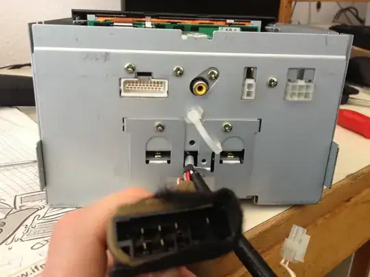

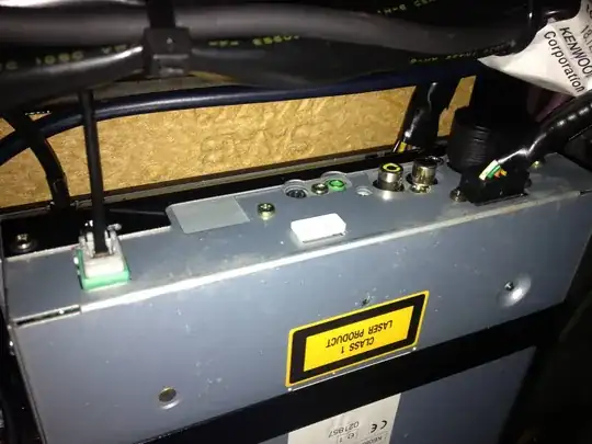

I only have pictures from the outside yet as I haven't yet uninstalled and opened it. However, these pictures are already interesting. You have two cinch connectors there which look very much like a line audio input. There is also some not-connected plug with 5 pins (or so). Maybe that is for telephone and it would enable the cinch audio input somehow?
main unit behind 1 main unit behind 2

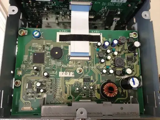

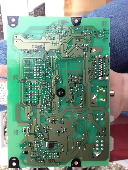

About the head unit board:
What is that CN5 connector on the board which is not plugged?
Or, from the input adapters here or here, I'm not sure whether they might already fit to some of the connectors. (It says there that it is for Saab 93/95 from 2006-2009, but mine is a Saab 95 from 2004, so not sure if it is compatible.)
Or, what is that yellow cinch plug on the back? Edit: That is video input as it says on the back of the board.
Or, is the whole unit just digital and the digital-analog conversion is done somewhere else in an external amplifier? I think that 6-pin plug is the output. I'm not sure if that is something digital or analog.
What are (or might be) the connectors ACC, PARK, ILL, ILL-CONT, BU, REMO?

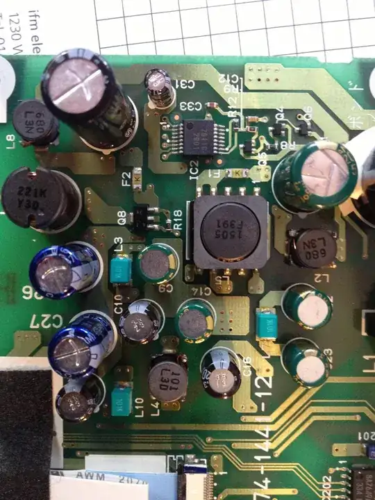

  • 7611C. Not sure which one. Maybe an amplifier? The whole section of the board seems all radio related (multiple coils and capacitors - I added a picture of that). Or maybe this one (Bipolar IC For Switching Power Supply Control).
board board back board. radio? board. something? back navi front

  • It's written "video in" on the back of the PCB near the yellow cinch. Isn't it? – Blup1980 Jul 02 '13 at 12:18
  • Those "caps and coils" you indicate are just power supply. Looks like the audio amplifier would have been where all that empty space in the box is located. Perhaps on the cheaper sound system (non-navigation) the amplifier was in the head unit, but in the navigation upgrade they use a remotely located multi-channel amplifier. In my car (Pontiac Vibe/Toyota Matrix), the amplifier is located under the passenger seat. – DrFriedParts Jul 02 '13 at 13:40
    @DrFriedParts: Thanks a lot for the hint. I searched around and found this. So it seems that there probably is no audio signal at all in the head unit. It's all in the back. – Albert Jul 02 '13 at 14:12

  • It has a CD changer. But I thought it would transfer only the digital data and do the digital-analog conversion on the board? I added two more detailed pictures from two sections, one of it probably the radio part. I'm also researching the chips; I think the 7611C is some sort of amplifier. The 20-way connector definitely seems digital from the names of the pins (you can see that on the second image). – Albert Jul 02 '13 at 12:45

  • Do you mean the ISO C connector described here. Those 20 pins seem to be very different from the descriptions on the board. The ISO C conn seem to have the analog audio signals, whereby the 20-way conn on the board seem to be mostly digital (M DATA, M CLK, N SYNC, N TXD, NG, NB, NR, M REOC, M CON, M REOH, RESET, N RXD, ...). – Albert Jul 02 '13 at 13:19

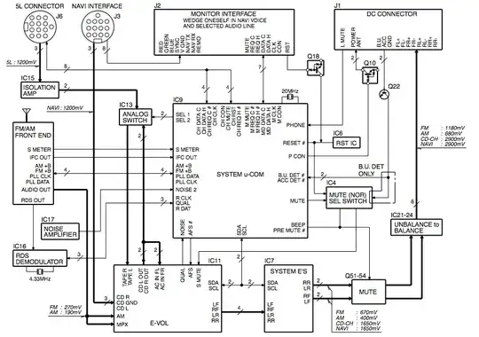

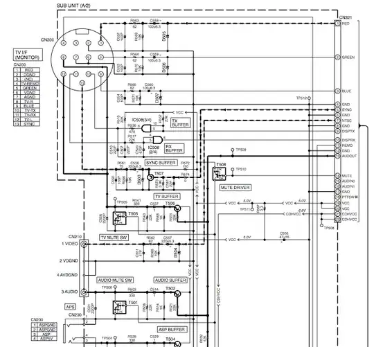

If you look at STC-700 Internal Schematic PDF (I am not vouching for the source/site) This is the actual audio/control unit of the system. The Head Unit does not do anything with the audio directly. The DV2200 is just the GPS Nav System.
The STC-700 has the RF and CD/Tape/Nav Audio sections. The above PDF has the entire board layout, block diagram (as below) and the actual schematic of the board.
It should be near the NAV system you have pictured.
Main IC's are the IC11 (E-VOL) TDA7407 Advanced car (audio) signal processor and IC13 TC4052BFN Differential 4-Channel Multiplexer/Demultiplexer The 4052's Control Line A is tied to ground, while Line B is tied to 8V through a resistor, and connected to a transistor (DTC124EUA NPN) controlled by the Main Processor (When the transistor is active, it grounds the control line). This means audio lines X/Y0 (5L Connector/Cd Changer) and X/Y2 (CD Out 7407/Nav System) from are used, X/Y 1 and 3 are not. You could tap into that.
The weird thing is that the NAV's audio goes to the TDA7407's CD IN (buffer stage). The CD IN is both an input to the 7407's audio selection, but also tied to CD Out. This is then tied to both the AC IN RF & LF (Pre-speaker input right/left front channel), and the 4052's X/Y2. The X/Y0 is from the 5L connector, assuming a cd player. By default, unless the transistor is active, the X/Y2 is selected, which is connected to the 7407's TAPE IN L/R lines.
So one of two things could be happening. The system is set up so that the 4052 multiplexer is always used, or it's only used when the main ic knows there is a cd changer involved. For the most part, the 7407 can directly access the CD IN line which is tied to the NAV, so the multiplexer is only needed if the cd changer is present. Hell, I don't think it's needed at all, but I'm not a highly paid car stereo engineer.
IF it's the first case, you could tap into the 4052's extra input X/Y3, add a resistor and switch to Control Line A (tie it to ground through a resistor, and tie the switch to the pin and the 8v used), and once you enable it, you should hear audio when you are in Nav mode. This might cause you not to hear the nav when it is trying to speak.

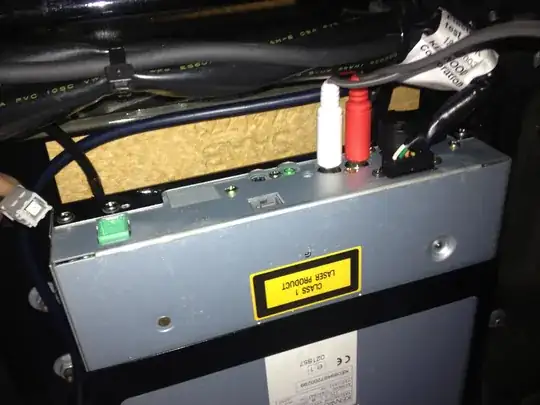

Edit: The DV2200's service manual (Full schematic and pcb) (Again, not vouching for website) shows that the back connectors are Video and Audio. The Yellow rca connector is Video Out, the Black connector is Audio Out. Same audio tied to the DIN connector on the right of the rca connectors (Pin 8 and Pin 12, R & L Audio to CD IN R/L, but both are tied together at the NAV so the same signal to both sides) enter image description here
So Obviously, the White RCA cable should go to the Head Unit's Video In, but where does that Red RCA cable that you picture go to?
