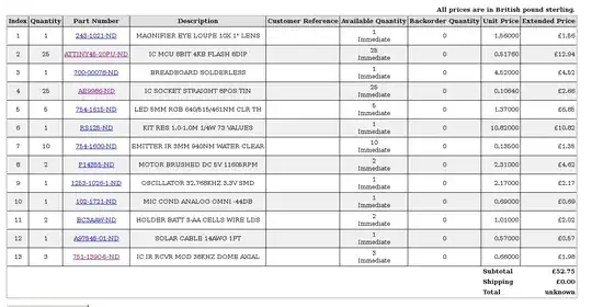

Any/all of the above sound like fun and I would really like to try and do at least 1 or 2 of them. I have absolutely no electronic related stuff at home. What should I get and what will I need? So far this is what I have thought of:
Part numbers can be looked up on the Digikey website but I can't post any more links.
I am hoping to be able to program my microcontrollers with my Raspberry Pi. I am still missing jumper wire as I couldn't find any on Digikey. I think I will also need some transistors but I'm not sure which ones to get. Would I be able to run the DC motors with some transistors from the microcontroller?
I don't have a good soldering iron (I have one somewhere but I honestly don't think it can even melt the solder) and I do not have a multimeter. However together getting those will likely already come to £50. Do you think that they are essential to get started?
Thank you for reading. I really would be interested to know what you think is most important to get first when starting out and what other items I have missed from my list that I will need.

  1. Your choice of microcontroller. Although ATTINY45 seems good, reading the ideas of your pet projects I would recommend either ATmega168 or even better ATmega16L. These two microcontrollers are 4 times in cost as compared to ATTINY45 so it might cost 2 to 3 bucks in your currency.
  2. What type of IDE are you going to use and what type of programming interface such as JTAG, ISP or Parallel Programming are you going to use?
  3. With ATTINY45, you do not have enough pins to run LEDs although you might be able to debug with 3 atmost because it doesn't have enough pins
  4. Although using 3 AA batteries would be a good idea for portability, they might run out fairly quickly and might cause unwanted problems when the batteries start to die out.
As for transistors, you can get plenty of general purpose transistors like the BC546 (my personal favourite) and YES you can run DC motors with transistors but small motors which you find in battery operated pencil sharpers, hand-held fans, etc as running motors will draw quite a bit of current which will make your transistor hot or even damage it.
If for instance you setup everything and things do not seem to work, you would need a multimeter. Its quite an essential tool when setting up the hardware. You do not need solder if you are using a breadboard. Breadboards can be quite expensive and you might want to go in for veroboard (or pre printed circuit board) for which you will require a soldering iron. I do not know what the prices are for tools like these in your country but if you do get a hot iron, do not save money as buying a good iron will save you money in the long run (speaking from past experience).
