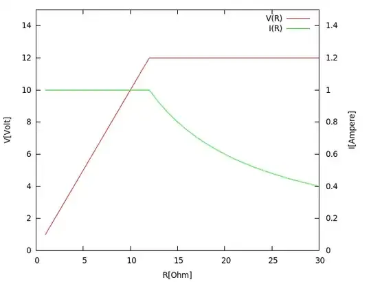

I drew a graph for how a current limited power supply will act with varying resistance connected. Consider a 12V power supply limited to 1A.
  • The X-scale varies the load resistor from 1 to 30Ω;
  • The left Y-axis and red line represents the ouput voltage of the power supply. Clearly when the resistor is too low, the power supply output voltage drops, to fulfill the 1A max output;
  • The right Y-axis and green line represents the output current. Once the maximum output voltage is reached the output current will drop inversely proportional with the resistor value.
  • You can clearly see voltage regulation taking over from current regulation at R=12Ω
