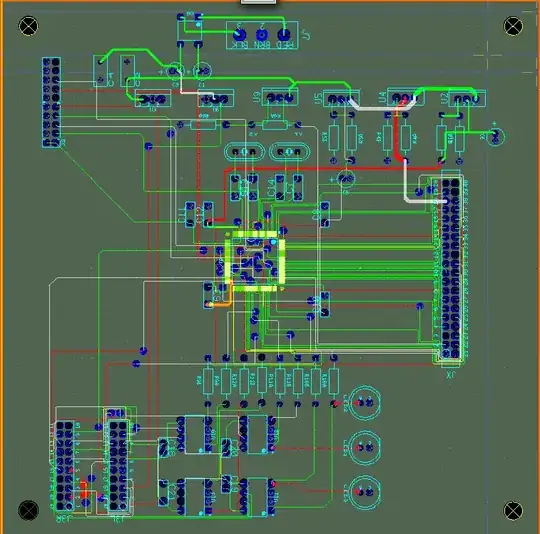

I am designing a control board for an analog audio amplifier, with a touch screen interface.
This is my first board I have ever laid out and routed and I was just wondering if people check my design look before I send it out to get it printed.

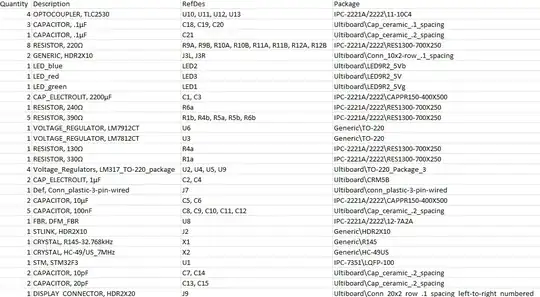

Below is the BOM
Screen capture of the board it's a four layer board with the top inner layer being a ground plain.
Let me know what ever you think. Like I said this is my first time laying out a board so I did use the auto router and the fixed it in some places. I would rather be brutally honest and tell me to redesign if need be, before I waste $66 on a board that isn't going to work.

  • @abdullahkahraman Did you auto-route this board? – Nick Alexeev Jun 16 '13 at 22:56

  • Okay well the harshness is what I was expecting. I have scrapped the above design and decided to try a fully hand route a 2 layer board. Once done I will update the question and be way more exact with any questions that i have remaining. Thanks for the insight. – JWL Jun 17 '13 at 14:05

Just a couple of random points. I didn't do a complete analysis, mostly because what I saw was serious enough to not warrant that.
  1. Switch to SMD ceramic caps. The lead inductance of TH caps makes them practically useless (talking about the normal 0.1 uF caps, not bulk caps).
  2. Might as well switch to SMD resistors, too.
  3. Power traces look very thin. Especally the lines going to the linear regulators.
  4. I have no confidence that you calculated the thermal dissipation of the linear regulators, or that you have a way to cool them.
  5. The vias look very large. Might be able to make them smaller to give you better signal routing.
  6. It is very hard to tell from the picture, but I think that you have vias so close together that they are forming slots/voids in the power/gnd planes.
You can use more wide tracks if you have no specific space constraint. Specially power and ground tracks must be as wide as possible. And ofcourse SMD capacitors are more suitable than TH and important thing is that capacitors must be place as close as possible to microcontroller and filtering capacitors to power regulator (if using) ,,, and their must be wide
You should also try to avoid right angle traces. This will cause an edge on the signal, if you were to hook an oscilloscope to it, which may cause issues

The layout of the crystals doesn't look right.
  1. Per BOM, the X1 is in the R145 package (it's a cylindrical package). In the layout it looks more like HC-49 package.
  2. There a tips for the PCB layout for the crystal on the p.17 of the ST app note AN2867. More discussion on the layout for the crystal can be found in this thread.

  • @JWL Did you auto-route this board? – Nick Alexeev Jun 17 '13 at 02:18
  • Yes, At the time I didn't know that it was such a bad idea to do that. I going to try to relay out the board with only 2 layers and hand route must of the thing. – JWL Jun 17 '13 at 02:45
    Using an autorouter for one's very first board is indeed not a good idea. Autorouter has it's uses. But, beginners usually over-use autorouter. – Nick Alexeev Jun 17 '13 at 02:59
