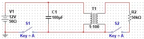

The above image shows the only two components in the circuit. I do not know for a fact what the white component is, but I have to assume it is a high value capacitor.
The above image is a literal layout of the circuit. The 50k load is the user's hand. Both switches are closed upon pressing the button. The switch is before the capacitor. This is based on closely observing the circuit and is 100% accurate unless someone can prove otherwise. I tested this with varying capacitance and inductance values and was unable to induce a significant current in the load for more than dozens of miliseconds. When testing I moved the virtual switches from the ground to the positive wire. When I move the switch after the capacitor I can have a long lasting current through the load, but the voltage/current are very low.
Edit: It is beginning to appear as if the white piece (Shown as cap above) is an active component/IC. There may not even be a capacitor in this circuit.

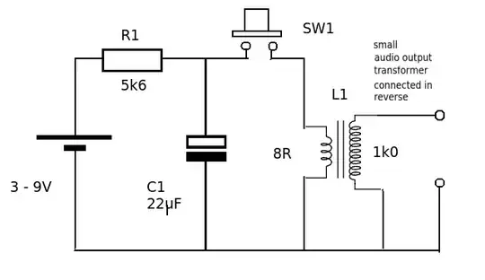

Here's a little circuit that might fit the bill
The battery charges the capacitor (C1) through a resistor (R1). When the switch is operated the charge from the capacitor is dumped into the primary of the transformer. This produces a damped oscillation (LC circuit). The transformer secondary has a lot more turns than the primary and so the VOLTAGE part of the short burst of alternating current in the primary will be magnified by the turns ratio. The current part will be diminished. The total energy delivered to the 'shock' can be estimated from the energy store in the capacitor. (0.5 * C *V^2). For the values given = 0.5 * 22 * 10^-6 * 9^2 Joules or 891 micro joules - pretty harmless. The transformer is a small audio output type but others can be used such as the trigger transformer for a flash tube (hacked from a cheap camera) or you could even wind you own on a ferrite ring.

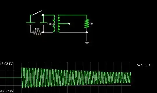

4 variables.
  • Vbat
  • Primary inductance
  • Turns ratio step-up tapped auto-transformer
  • C
  • R Skin resistance 1M ( tiny contact)
Simulation
CLose switch and Vout = Vbat * turns ratio Open switch and LC^2/2pi = 1/resonant f Positive HV is V=L di/dt
Tony Stewart EE75
  • 54
  • 185
    In your simulation the battery voltage and internal resistance are unreasonable. The voltage in the actual device is 6V and the internal resistance (according to the datasheet) is at least 50ohms. Also, the skin resistance when gripping the pen is much lower than 1M. The step up ratio can then again be larger.
    Do you claim that the shocking action occurs when the switch is open? The switch opens (as for as I know) when you release the button, and are no longer in contact... I don't understand that
    – Trever Thompson Sep 13 '16 at 07:16
  • I agree on VBat & ESR. I wasn't sure but thought the voltage was between tip and hand so I used 1M from a dry finger to get more voltage on release. I also assumed release of switch occurred before release of tip. , I can simulate 100K which will reduce amplitude and duration – Tony Stewart EE75 Sep 14 '16 at 04:28
  • So how do you consolidate the internal resistance? I have those small batteries at home and three in series gave about 40 ohms. Also, I am beginning to suspect strongly that the white piece is an active component. If it incorporates timer and a transistor which opens and closes the circuit everything may start making more sense. Your thoughts? – Trever Thompson Sep 14 '16 at 08:13
