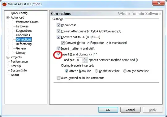

I just downloaded it to take a look and found it under the menu item VAssistX | Visual Assist X Options - just disable the circled checkbox.

  • I had no idea what VAssistX was; in VS these options are elsewhere. Nice find, thank you! – JYelton Jun 13 '13 at 08:13

  • This send me in the right direction. With the newer versions, now called Microchip studio, the brace autocompletion option is now in the section "Editor" instead of "Corrections" – Grebu May 28 '23 at 17:27
