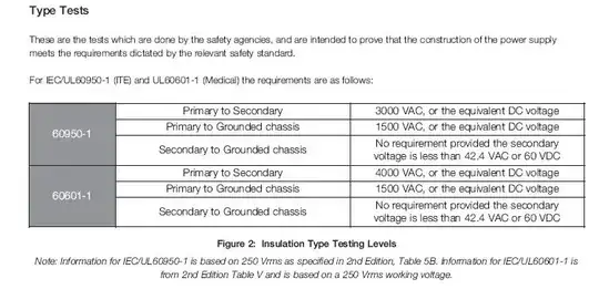

If you really want to be sure you need to do Hi pot testing: -
Here is a great document from XP that explains it. Class II is what you are looking for i.e. no earth connection. You cannot check that you have galvanic isolation with a multimeter and realistically hope to believe it although you can definitely disprove galvanic isolation if you find some degree of conductivity.

  • You cannot verify that the supply meets regulatory safety requirements with a multimeter. But you can certainly see if the supply is isolated. –  Jun 10 '13 at 21:25
  • @DavidKessner If it were the audio power output on a PA feeding several distributed loudspeakers I agree that the multimeter test is sufficient to prove the PA uses an output transformer but not on a SMPS. I guess I'm saying that galvanic isolation doesn't necessarily mean safe. – Andy aka Jun 10 '13 at 21:55
  • You're right that Galvanic isolation does not mean safe. But assuming that the power supply was designed correctly and passes the appropriate regulatory tests (which would be the case with a commercially bought supply) then a multimeter test should correctly indicate if it is isolated or not. As would reading the datasheets, if available. To be absolutely sure, you need to do a Hipot testing, as you mentioned, but few people on EE.SE have the equipment or knowledge to do that. –  Jun 10 '13 at 22:24
