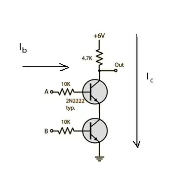

Firstly your dealing with a small signal general purpose transistor so there will be a range of current that you can safely pass through it, (Ic). Suppose we decide to limit this current range to between 1mA and 50mA . This means that for a 6V supply the resistor can range in value between 6k (for 1mA) and 120R (for 50mA).
A 4k7 resistor limits the current to about 1.3mA - a value near the lower end of our current range (low power requirement/dissipation) and so it would be deemed as a suitable value. 5K6 may be a better choice.
Having set this value of resistor we then look at a suitable value for the input resistor. The current gain of a general purpose signal transistor is going to be in the range 50 - 300. Lets assume the worst case and take 50. Then for a current of 1.3 mA we will need at least 26 microamps (.026mA)
The worst case for input is this circuit.
Input A has to be close to the 6V line to get any current into the base of the top transistor. The 10k value will produce a voltage drop of 0.26V @ 0.026mA. A lower value would produce a lower drop but would also mean higher base current in the other configurations. Once again it becomes a compromise between too much or too little. The 10k value sits in the 'goldilocks zone' and is just right.

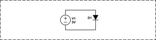

(hint: it's not much different from this circuit)
schematic
simulate this circuit

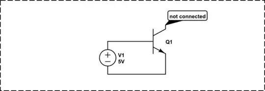

How much current flows? A lot. This is an NPN transistor, so called because it is constructed from a sandwich of N, P, and N doped semiconductor. That is, it's two diodes back to back sharing a cathode (a diode being just a PN junction). The base-emitter junction is exactly a diode, and that's why it has an arrow. The base-collector junction is also a diode, and the only difference is that the asymmetrical construction of the BJT means you won't get a very good transistor if you try to use it backwards like this.
Like any diode, the current that flows in the base-emitter diode, once forward biased (about 0.65V for any silicon junction) is limited only be the internal resistance of the diode1, and the resistance of the wires. This is the same reason you need a resistor or other current limiting device when driving an LED from a voltage source.

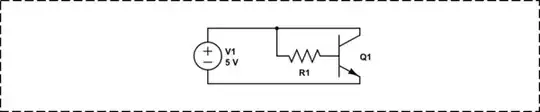

Likewise, consider what happens here:
schematic
Hint: it's not much different from this:
schematic
(\$0.2V\$ being the collector-emitter voltage of a typical BJT in saturation, and the base current being small enough to be negligible).
Again, you get smoke. The resistors are there to limit the current through the transistor.
