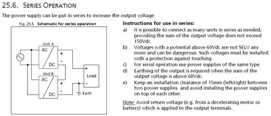

This can't be answered in general without knowing the details of your power supplies. Some will accept being connected in series without problems, some might not and start to become unstable. To be sure, you need a manual, ideally with a section like this:
PULS CS10.481, Series Operation
(Source; Note that this same supply will not accept being operated in parallel with another one, which is o.k. for other supplies.)

  • Pretty fair answer I'd say +1. One caveat, if you can technically wire them in series with the centre point at protective earth i.e. -48 0 +48 then this "overcomes" the SELV issue. – Andy aka Jun 01 '13 at 21:07
  • Nevertheless, you said "may be components in your supplies that won't accept the increased voltage." You meant that Inside the supplies there is components that cannot cope 96 V ? How can it be ? they should not see this voltage ? The 96V is for a device that accept it. – user1816813 Jun 01 '13 at 22:25
  • I don't understand the first of the "common gotchas". Both power supplies are driving current in the same direction around the loop, and both will go into current limiting. Nothing is "forced backward". – Dave Tweed Jun 02 '13 at 00:54
  • @user1816813: Think about Y capacitors at the output. Depending on where or how the case or PE of the supplies is connected, these capacitors might not be within their specification any more. Draw a schematic of your setup, including the cases of your supplies. – zebonaut Jun 02 '13 at 06:28
