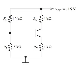

I don't understand why R1 and R2 are in parallel.
I need to find the Thévenin resistance of the circuit, and my textbook says that R1 and R2 are in parallel, but I don't understand why.

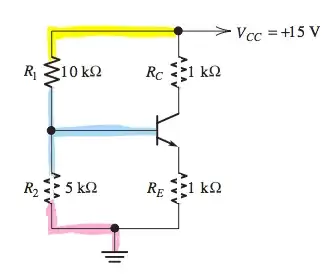

I really struggle with identifying when resistors are in parallel, and a useful technique I created for myself was by colouring the wires connected to each end. Here's an example:
Since both ends of the resistors have the same coloured connections, I can see they are clearly in parallel configuration:

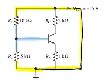

But when I do this for the BJT circuit above, I get the following, which makes it seems like they are not in parallel:
Is it because VCC is connected to the same ground node below, so when it is shorted for Thévenin resistance, it forms the following?

    VCC is GND, when you're computing signal impedances. – Neil_UK Mar 23 '24 at 08:08
  • https://electronics.stackexchange.com/questions/471906/calculation-of-base-current-and-what-decides-the-current-through-collector-emitt/471923#471923 – G36 Mar 23 '24 at 09:06
  • Imagine the ideal voltage source as a 0-ohm magic wire but it also creates a voltage difference across it. It's how the Thevenin theorem works. – 比尔盖子 Mar 24 '24 at 14:55

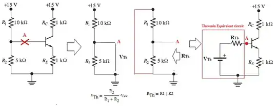

Thevenin's theorem applies as follows:
Franc
  • 1,126
    [Addition to the spot-on figures of this answer]. For a DC analysis purpose, including bias circuit analysis, the question's resistors are not in parallel. They are in series connection. The coloring method in the question works. The reason to consider the resistors in parallel is for computing the resistance Rth in the equivalent Thevenin generator (right drawing). For this we mentally replace the +15V generator by a wire (3rd drawing), and the two resistors become in parallel. The coloring method in the question still works, but now there is one less color. – fgrieu Mar 23 '24 at 10:06
