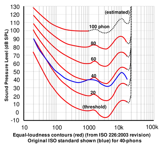

edit: Another thing, transformers tend to vibrate slightly during operation. A 60 Hz transformer will "hum" a little bit. But imagine all the appliances in your house buzzing at 1 kHz. 1000 Hz is two octaves above middle C, and our ears are 30dB more sensitive to this frequency than 60 Hz: alt text
Image source: http://en.wikipedia.org/wiki/Equal-loudness_contour

  • The chart seems to indicate 1kHz AC or so would actually be quieter than 50/60 Hz. – Thomas O Nov 22 '10 at 22:56
    read the chart more carefully. The Y-axis is SPL and the lines are equal loudness. So a 20 dB SPL at 1 kHz sounds as loud as a 57 dB SPL at 60 Hz. – markrages Nov 23 '10 at 00:42
