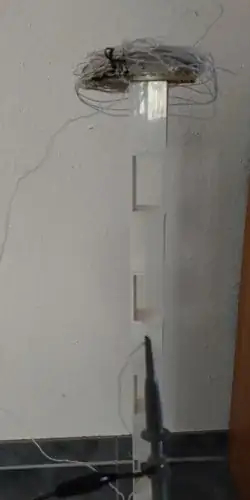

I measure with an oscilloscope with the probe connected to a 16m wire floating in the air with 50cm distance to any mains wiring except ground. 1m of the wire is unwounded, 15m are wounded as a coil, see the picture if unclear. Oscilloscope ground is connected to mains ground. Ocilloscope has 71pF voltage measurement including its probe. Antenna with oscilloscope probe

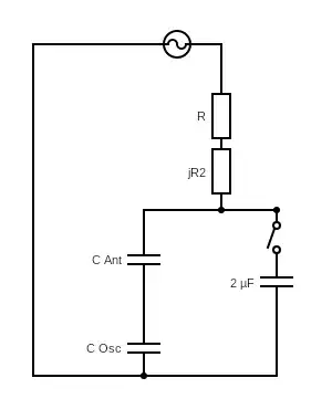

I modelled the situation as following:
  • R and jR2 are the internal impedance of the 17kHz source, not 0
  • C Ant is the emitting of the mains and picking up of the electrical field by the wire
  • C Osc is the capacitance for measuring voltage by the oscilloscpe
model
In theory I expect the measurement values to get lower when the 2µF capacitor is turned on because there now is a path with lower impedance and the internal impedance of the source is not 0, so the source has not enough power to hold up voltage at the high impedance path I measure. But in pratice the measurement values when turning on the capacitor get higher and this is uncorrelated with distance to the capacitor.
Does my measurement setup not measure electrical fields? I am not 100% sure if picking up of electrical fields by my antenna can be modelled as capacitor C Ant? Ultimately I am interested in a measurement setup where the measurement values get lower when the capacitor is turned on with the following rules:

  • What's the point of the antenna? Why not just measure the voltage of the 17 kHz signal directly on the mains, with and without the 2 µF capacitor? In any case, the coiled-up part of your long wire is doing you no good at all. – Dave Tweed Mar 18 '24 at 12:36
  • Measuring in air is more fascinating and more secure than measurung with mechanic connection. Never connect an oscilloscope directly to mains, see https://electronics.stackexchange.com/questions/674280/measuring-differential-mode-hf-on-mains-with-oscilloscope?rq=1 . – Hansebenger Mar 18 '24 at 13:40
  • I have re-measured with a shorter wire without a coiled-up part, same result. – Hansebenger Mar 18 '24 at 13:41
