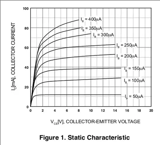

The datasheet will give the details about how \$ V_{ce} \$ relates to \$I_c\$. Here's BC547:
collector-emitter voltage graph
You can see that if you hold the base current constant, then \$ V_{ce} \$ is not a linear function of \$ I_c \$, as it would be if the collector-emitter was a resistance. You can also see that if you hold \$I_c\$ constant, then increasing the base current can make \$V_{ce}\$ lower, up to a point.
For example, let's say our base current is \$50 \mu A\$, so we use the lowest line. Say collector current is \$10mA\$. It looks like those lines intersect at about \$0.25V\$, so the power is:
$$ 0.25 V * 10mA = 2.5mW $$
