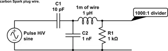

A cheap safe way is to make a capacitive voltage transformer. with coaxial output to scope terminated in some resistance due to wire inductance.
The choice of cap depends on expected voltage and may be created with extra safety margin with a string in series.
schematic
e.g. 10x 100 pF 3kV in series is 10 pF in a series string may be good up to 30kV and give 30V pulse output
