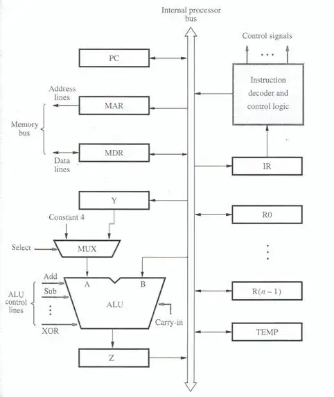

Below is diagram of the basic registers and control circuits of most processors. There are a few more registers than we've been discussing. You can ignore those for the moment for the purposes of this discussion or read more about them at your leisure. Hopefully the visual aid will help make things a bit clearer.
CPU diagram

  • Once the Byte is split into the MAR what is happening (like where does the address from the MAR go to). What is the control matrix doing? Is it just choosing what to do with the MAR or what?. BTW your picture def. gave me a much better understanding of the RAM and how it's modeled. –  May 23 '13 at 18:56
    @Mercfh Sticking with that terminology and trying to keep it simple, the address in the MAR tells the address decoder which address lines to toggle. Once the RAM gets the address from the decoder, it puts the data at that address on the data bus where the processor can get at it. The opcode tells the control matrix what function to perform. So depending on the opcode, the control matrix will either move data from the data bus and put it in a register or it will move data from a register and feed it to the ALU or it will move data from a register back to RAM, etc. – embedded.kyle May 23 '13 at 19:11
  • So wait....does the PC go into the IR or MAR? Since your talking about the decoder going into RAM right? So it must be PC--->MAR--->Decoder--->RAM correct? Where is the IR in this setup? –  May 24 '13 at 15:59
    @Mercfh The PC goes into the MAR. When fetching an instruction, the address in RAM to get data from comes from the PC. When fetching data, the address comes from the address operand of the instruction. I've added a diagram that I hope helps. It includes a few more registers but if you ignore those the picture in your head should be a little clearer. – embedded.kyle May 24 '13 at 17:18
  • Wait you said the Address in RAM to get data comes from the PC?.....Ok im either really stupid or confused, Is the PC connected to the MAR and RAM or just the MAR. Diagram does help but I wish there was some sort of "line" drawn to show like the path it would take. (like even a MS paint line showing the path a simple instruction would do) –  May 24 '13 at 18:14
  • @Mercfh No, the address in RAM to get an instruction comes from the PC. The address in RAM to get data comes from the address operand of the instruction that was fetched. Since it's a multi-step process with each step flowing through a couple of registers, it would take many diagrams to show the path. But I've added some text to show how each step flows. Let me know if it's still unclear. – embedded.kyle May 24 '13 at 18:28
  • ok what you've posted makes alot more sense now. Thanks! In your diagram is the RAM you are referring to labeled Y? –  May 24 '13 at 18:34
  • @Mercfh No the RAM isn't pictured. It's off to the left where it says "Memory Bus". The MAR and MDR are the registers in the processor that affect the address and data bus that are connected to the RAM. Y, Z, TEMP, R0...R(n-1) are all just other registers in the processor. The set of which will vary in number and name depending on the processor architecture. In my discussion above, Y and Z are just one register called ACC. Don't pay too much attention to the names of things but focus on the function as the names will vary greatly between architectures. – embedded.kyle May 24 '13 at 19:05
  • AH ok that makes alot more sense haha. –  May 24 '13 at 23:14
