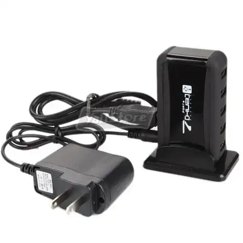

I bought a cheap USB Hub Powered to connect my Raspberry Pi and two External Seagate HD (USB 2.0/3.0), but obviously that 400 mA is not enough for all this things.
So, I want to buy a new AC Adpater that supports 5V/2A.
There is a risk to combine a cheap USB Hub with 2A Adapter? Can I damage my Raspi if i put only it in Hub + 2A AC Adapter?
EDIT:
I want to connect Raspberry Pi [700mA] and Two External HD (2.0/3.0) [>500mA]. To make it possible I need a USB Adapter. The problem was that the USB Adpater what I bought is really cheap and the AC Adapter is only 400mA (insuficient for 2 External HD).
I could buy a nice USB Hub (80 dollars), but I'm questioning myself if i could buy 2A AC Adapter (4 dollars) plus use my cheap USB Hub (5 dollars).
USB Powered Hub 2A AC Adapter

The Power input on the Pi is a micro USB connector, but it only uses the power traces, and not data. The Pi needs 700 mAmps, and 1A is safer. Many hubs will not (and should not) supply this much current. The hub will not care about how high a current the adapter can provide, so you won't damage the hub. You also won't damage the Raspberry Pi, but it might brown out. With a 400mA power supply, I'd expect brownouts even if you had no disks.
Unless there's a reason to power the Pi off of a hub, you could just get a usb charger with the right connector on the end, and power directly into the Pi.
