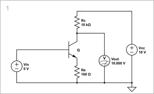

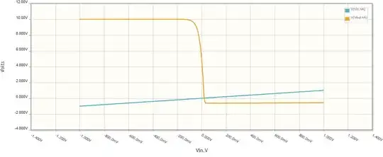

No biasing

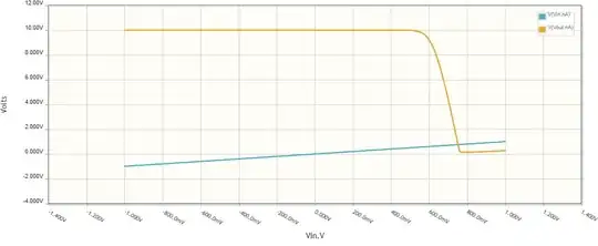

The problem with the transistor is that it operates in a very small input voltage range (about 200 mV). We can explore it by "sweeping" Vin (run the CircuitLab DC Sweep Simulation).
schematic
So, when the input voltage changes from -1 V to 1 V, the transistor properly works (amplifies) only in the region from 600 mV to 800 mV.

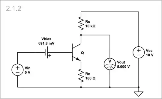

In series: The obvious way to sum the voltages of the two sources is to connect them in series. We can connect them in two ways, but always one of the two sources is "floating", which creates inconvenience.
Grounded bias source, floating input source: It can be used with floating voltage sources such as microphones, sensors, etc.

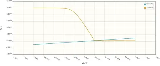

As you can see, the amplifier transfer curve is symmetrically located with respect to the zero voltage point.

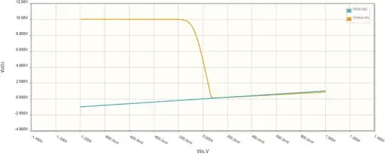

In parallel: Let's try this option as well, even though it seems impossible.
Conceptual circuit: The simulator does not allow "ideal" voltage sources to be connected in parallel; so let's set some very small resistance (1 Ω) to one of the two sources (Vbias).
schematic
simulate this circuit
As you can see, Vin dominates over Vbias, and actually there is no biasing.

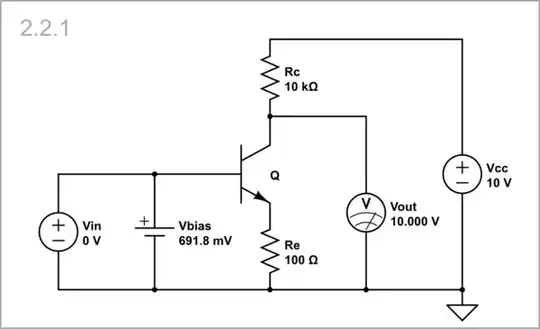

STEP 2.2.1

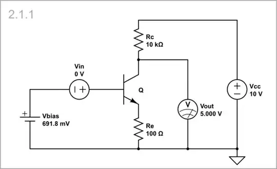

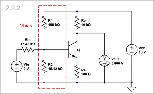

Voltage divider: So Vin should be connected through another resistor Rin to the base. Vbias can be implemented by an R1-R2 voltage divider. Thus the three resistors form a resistor summer with weighted inputs that sums Vin and Vbias.
schematic
The disadvantage of this resistor coupling is that the input voltage is attenuated, and the gain is decreased (the transfer curve is steeper).

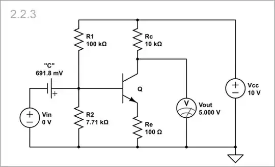

Coupling capacitor: There is no such a problem if Vin is connected through a charged capacitor. For convenience, we can simulate it in a DC manner by a "rechargeable battery" without worrying about time and frequency). Note that actually the coupling capacitor is connected in series to Vin like in the Schematic 2.1.2 above.
schematic
The transfer curve is the same as in the Schematic 2.1.1.

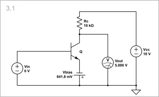

By voltage: We can place Vin and Vbias on either side of the base-emitter junction; so they are effectively connected in series as in the Schematic 2.1.2 above. An advantage of this connection is that both voltage sources are grounded.
schematic
Note that the gain has increased because there is no negative feedback (resistor) in the emitter.
STEP 3.1
So the emitter will be at permanently fixed voltage Vbias which is not always desired. For example, in a differential amplifier, we want in some cases (single-ended and differential mode) the emitter to be "fixed" and in others (common mode) to be "moving".

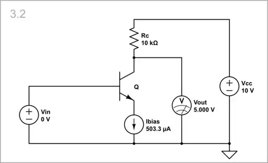

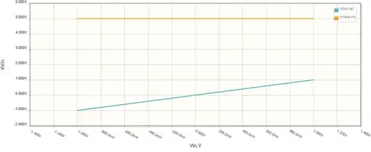

By current: Then let's try to bias the transistor by injecting a bias current into the emitter. Thus the emitter will be "movable" (Vin can easily change its voltage).
schematic
The emitter voltage changes, but the emitter current and, accordingly, the collector current and the voltage drop across Rc does not change... so there is no gain.

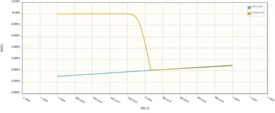

... and the gain is maximum.
STEP 3.3.1

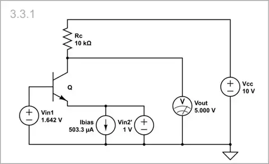

Vin2' = Vin1 (no amplifier). The emitter is "movable" (the behavioral voltage source Vin2' follows Vin1 with 0.642 V lower voltage)...
schematic
... and the gain is minimum.

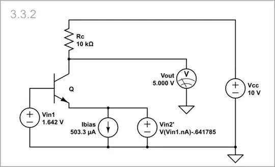

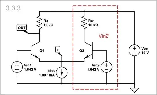

In the practical circuit this means to connect a second transistor "in parallel" to the first by joining their emitters. Thus we come to the famous "long-tailed pair".
schematic
Conclusions

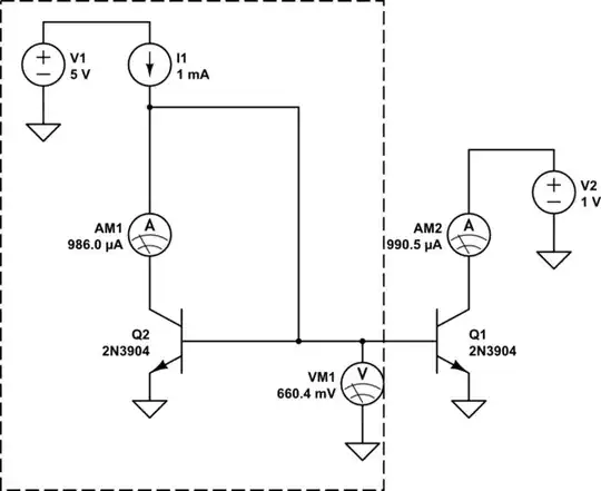

In the picture below, we have implemented a voltage source with a diode-connected transistor Q2 and current source (enclosed in the dashed box). If the surroundings and external conditions change (process variations, temperature, etc), this circuit will keep adapting its base voltage such that the current is 1mA (or close to it). Since Q1 is equal to Q2 in an integrated circuit (provided there's a proper IC layout), we can closely approximate the behavior of Q1 with Q2, so we expect that Q1 will have the same current flowing through it as Q2, because they have the same size and physical characteristics (there's the collector voltage difference which might induce a collector current error, of course, but that's beside the point).
schematic
If Q2 and I1 were replaced by a resistive divider, then we will not have this tracking behavior and we'd probably have more errors in the set current.
