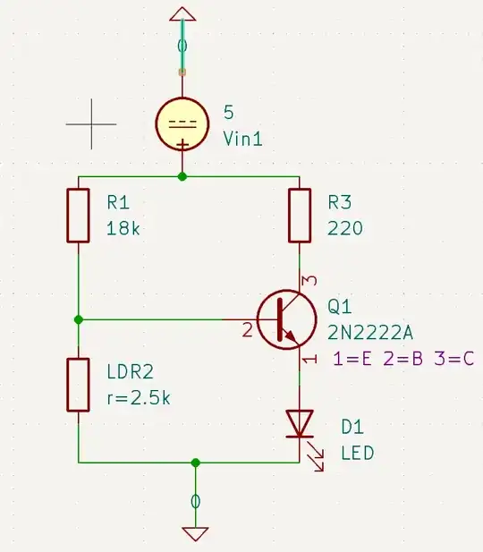

Here is the schema I've tested: light/dark circuit
As long as R1 has enough resistance to limit \$I_B\$ to not exceed the transistor’s specifications \$V_{BE}\$ will not go much above 0.6 V. The base-emitter junction acts as a diode so it limits the voltage.
Also in your circuit the LED is in the emitter path, so the divider voltage would need to be \$V_{BE} + V_{LED}\$ to turn the transistor on. If you want it to switch at 0.6 V you need to move the LED to the collector side with R3.

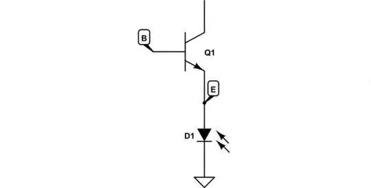

In the circuit you have shown us, you have a base-emitter junction in series with an LED, like this:
schematic
I'll assume the LED has \$V_F=1.7V\$
What this tells me is that the potential at the bottom of LED D1 is held at 0V (that's what the ground symbol means). The potential \$V_E\$ of node E, at the top of D1, cannot exceed \$0V + V_F = 1.7V\$. The potential \$V_B\$ at B cannot ever rise above \$V_E + V_{BE} = V_E + 0.7V = 0V + 1.7V + 0.7V\$. In other words:
$$ V_B < 2.4V $$
If you try to raise \$V_B\$ above that, both base-emitter junction and LED will become very, very conductive, passing whatever current they need to prevent their \$V_{BE}\$ and \$V_F\$ from increasing further.

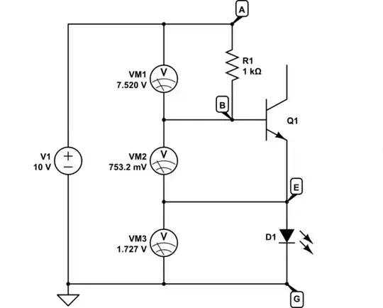

Let's put a resistor in the chain:
schematic
simulate this circuit
I've also added a few voltmeters to see how far we've "stretched" the three elements. I've placed 10V across the chain. In my analogy this would mean that I've tried to stretch ends A and G 10m apart. In your mind I'm sure you see that the two pieces of string \$V_{BE}\$ and \$V_F\$ are taught and rigid now, and can't get any longer, so the resistor must have stretched to cover the remaining distance.
That's what you see on the voltmeters. VM3 shows you the potential difference across the LED, which has been capped at 1.7V. The base-emitter junction is unable to have more than 0.7V across it, as shown on VM2. The remainder must be across resistor R1, shown on VM1.
If you didn't have R1 in place, and V1 was tied directly to B, you can imagine what would happen. You'd be stretching the two strings beyond their breaking point, and one or the other (or perhaps both) will snap.
Sticking with the analogy, if \$V_1 < 2.4V\$, that means the two strings are not extended to their maximum lengths. There's no tension in the system, and R1 would not be stretched at all. In electrical terms this corresponds to zero volts across the resistor. The entirety of V1 must be shared between D1 and Q1. It's only when the strings become taught that R1 begins to "stretch", the voltage across it beginning to rise.

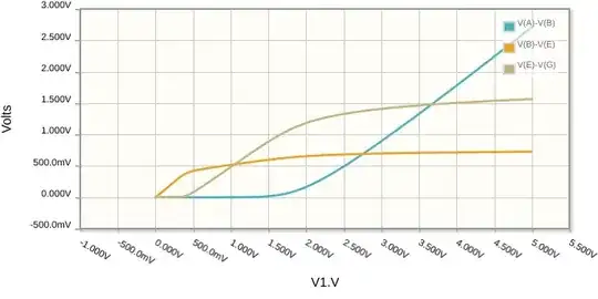

In the following graph I sweep \$V_1\$ from 0V to 5V, and you can see how the voltages \$V_{AB}\$ (across R1, blue), \$V_{BE}\$ (across Q1, orange) and \$V_{EG}\$ (across D1, tan) respond:
As expected, \$V_{BE}\$ and \$V_{EG}\$ begin to rise as soon as \$V_1\$ starts increasing from 0V, and each continues to rise until it "meets" its maximum, 1.7V and 0.7V respectively. R1's voltage \$V_{AB}\$ doesn't begin rise until Q1 and D1 have reached their caps.
These curves don't have sharp corners. All the descriptions I made above are somewhat approximate. The diode doesn't suddenly become more conductive at \$V_F=1.7V\$, and the transistor doesn't suddenly become more conductive at \$V_{BE}=0.7V\$. These transitions between states are much more gentle and smooth in reality.
