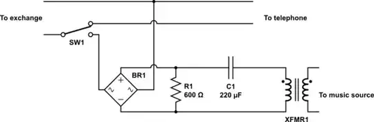

Telephones are two wire appliances that are grounded only at the exchange end.
A hold-music circuit could go something like this:
schematic
The resistor will probably get hot so use a 2W part (or 4 half watt 150 ohm resistors in series etc.)
600 ohms is a guess, measure the current and voltage during a call to get a more precise value.
"Music source" should be at approximately headphone power level.
This is not the best solution it is just the simplest.
