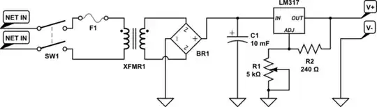

Really any basic power supply would do. For example, I use this:
schematic
Transformer, rectifier, large capacitor and a variable voltage regulator. You can also split R1 in two (5K and 500R) for extra fine tuning. Gauge the potmeter so you can see the output voltage without measuring.
    Thanks Camil, but I was more after "off-the-shelf" solutions rather than circuit diagrams. Simple instructions on how to connect a shop brought DC power supply to a breadboard would be perfect. – dumbledad May 17 '13 at 10:12
    Build it one time and it is off-the-shelf ;) –  May 17 '13 at 10:13
