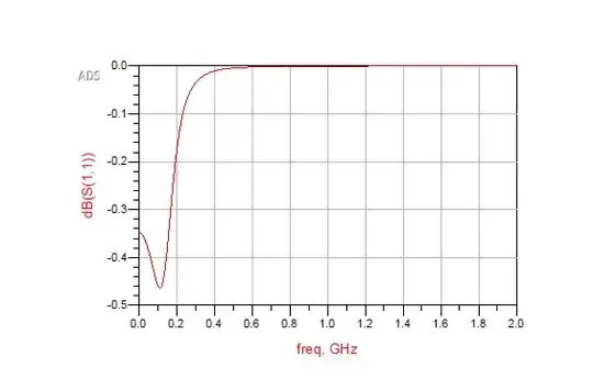

The general formula for resonance is \$w_0=\frac{1}{LC}\$ . A simulation was built with such inductor and capacitor so the resonance will be at 1GHZ.However as you can see in the result ,the plot shows a very small Q factor resonance and its resonating not at a frequency which differs the formula. Where did i go wrong?
$$ w_0=\frac{1}{LC}=1 GHz $$
ADS ADS schematics
ADS plot

Because you have not used the correct formula. You stated this: -
\$w0=\dfrac{1}{LC}=1GHz\$
A more suitable formula is this (note the square root of L and C): -
$$\omega_0=\dfrac{1}{\sqrt{LC}}$$
If you enter the values of 1 nF & 1 nH you get a natural resonant frequency of 159.15 MHz. The above formula yields radians per second and, to get hertz, you must divide by \$2\pi\$.
Andy aka
  • 456,226
  • 28
  • 367
  • 807
For the frequency -
The formula you quote gives you the radian frequency. 1 Grad/s = 1G/2pi Hz, roughly the 150 to 160 MHz we can read off the graph.
For the Q -
The inductor has a resistance of 1 ohm. This is probably a default the simulator assigned. As its reactive impedance is only 1 j.ohm at the resonant frequency, the Q will be in the order of 1.
Hint, if you do increase the Q by decreasing that inductor resistance, or increasing the inductance, you will need to improve the frequency resolution around the resonant frequency to be able to see a sharp dip in the S11.
Should you set the inductor resistance to 0 and get an infinite Q, think about what S11 you would expect with the port seeing an effective open circuit at resonance.

Well, notice that the impedance of your circuit is given by:
$$\left|\space\underline{\text{Z}}_{\space\text{i}}\right|\left(\omega\right)=\frac{\displaystyle1}{\displaystyle\sqrt{\left(\frac{\displaystyle1}{\displaystyle\text{R}}\right)^2+\left(\omega\text{C}-\frac{\displaystyle1}{\displaystyle\omega\text{L}}\right)^2}}\tag1$$
Now, we can see that \$\$ is at a maximum when:
$$\omega\text{C}-\frac{\displaystyle1}{\displaystyle\omega\text{L}}=0\space\Longrightarrow\space\omega:=\hat{\omega}=\frac{1}{\sqrt{\text{CL}}}\tag2$$
Which gives:
$$\left|\space\underline{\text{Z}}_{\space\text{i}}\right|\left(\hat{\omega}\right)=\text{R}\tag3$$
So, now we can solve for the cut-off frequencies:
$$\left|\space\underline{\text{Z}}_{\space\text{i}}\right|\left(\omega\right)=\frac{\displaystyle\text{R}}{\displaystyle\sqrt{2}}\space\Longrightarrow\space\omega:=\omega_\pm=\frac{\displaystyle1\pm\sqrt{1+\frac{\displaystyle4\text{CR}^2}{\text{L}}}}{\displaystyle2\text{CR}}\tag4$$
So, for the bandwidth we get:
$$\mathcal{B}:=\left|\omega_+-\omega_-\right|=\frac{\displaystyle1}{\displaystyle\text{CR}}\sqrt{1+\frac{\displaystyle4\text{CR}^2}{\displaystyle\text{L}}}\tag5$$
And for the quality factor we get:
$$\mathcal{Q}:=\frac{\displaystyle\hat{\omega}}{\displaystyle\mathcal{B}}=\frac{\displaystyle\frac{1}{\sqrt{\text{CL}}}}{\displaystyle\frac{\displaystyle1}{\displaystyle\text{CR}}\sqrt{1+\frac{\displaystyle4\text{CR}^2}{\displaystyle\text{L}}}}=\text{R}\cdot\sqrt{\frac{\displaystyle\text{C}}{\displaystyle\text{L}+4\text{CR}^2}}\tag6$$
Using your values, we get:
$$\mathcal{Q}=50\cdot\sqrt{\frac{\displaystyle10^{-9}}{\displaystyle10^{-9}+4\cdot10^{-9}\cdot50^2}}=\frac{\displaystyle50}{\displaystyle\sqrt{10001}}\approx0.499975\tag7$$
