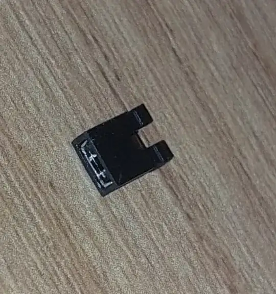

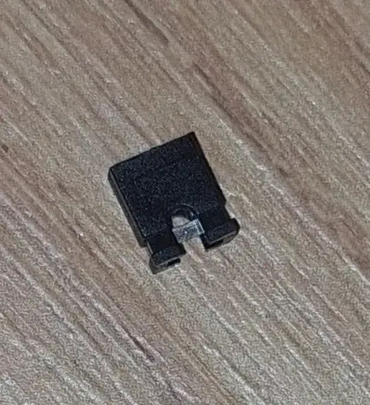

Can someone tell me the name and the function of the following component please?

It is called a jumper. It's nothing more than a piece of metal (covered by some plastic on the outside) used to connect to adjacent pins.
From an electric point of view, it's the equivalent of a very short wire.
In practice, jumpers are mainly used to "configure" PCBs, for example :
  • choose if output voltage is 3.3V or 5V (the jumper will connect a pin connected to the output either to 3.3V or to 5V)
  • chose between always ON or controlled by an external switch (if the jumper is present, it connects 2 pins, and is therefore equivalent to a closed switch ; if you remove the jumper, you can use the switch to turn your device on and off)
  • activate or not a buzzer
  • set the "address" for some communication protocols (typical on I2C hobby boards)
  • on old PCs, indicate if a hard drive is a main drive or a secondary drive
  • on some computers (specially embedded ones), to have automatic turn on as soon as they are plugged in (otherwise you have to push a button as on a classical computer)
  • whatever other configuration the PCB designer wanted to provide (without getting into the trouble of making a full user interface)
There are also a few more technical uses :
  • on PCB prototypes : allow to "cut" a track (by removing the jumper) so that one can test part of the circuit independently
  • on PCB prototypes : allow to "cut" a track (by removing the jumper) so that one can insert an amperemeter to measure the current

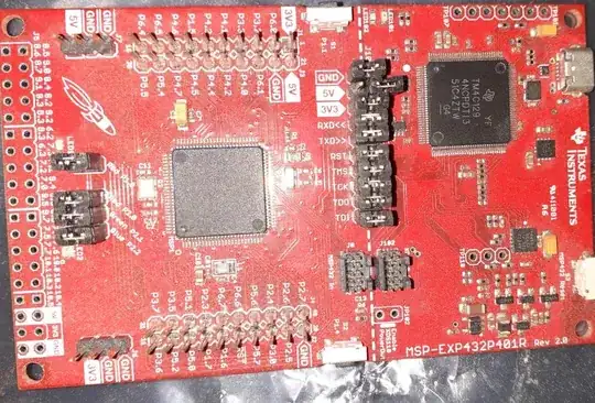

It is a jumper used to connect two adjacent terminals on a PCB. The spacing between the terminals can vary, but is usually 2.54 mm (0.1 inches).
The following is an example of configuring options on a development board, where all jumpers were connected except for the 5V supply connection between the JTAG debugger section (on the right) and the target microcontroller (on the left):
Where the 5V jumper was offset, so was not making an electrical connection, but was still on the board so I didn't misplace it if want to make the connection again.
