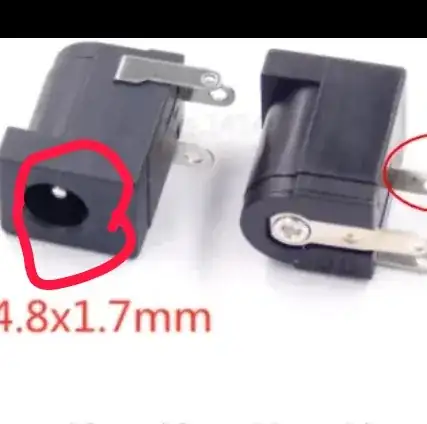

I have a DC port, can I make it positive or negative inside?

1It is up to you how you hook it up. It can be wired either way. – evildemonic Dec 14 '23 at 22:47
2Does this answer your question? Which end of a barrel connector is positive? – JYelton Dec 14 '23 at 22:52
what makes you believe that a difference exists? – jsotola Dec 14 '23 at 22:57

As long as you control the wiring of the plug and the jack, you can choose either polarity for the inside contact. It is when you are connecting to an existing device that you have to conform to that devices convention. Note that most equipment has the inside contact as positive but not all.

1Depends on the equipment. Many older devices commonly had negative on center, many modern devices commonly have positive on center. – Justme Dec 15 '23 at 00:06
