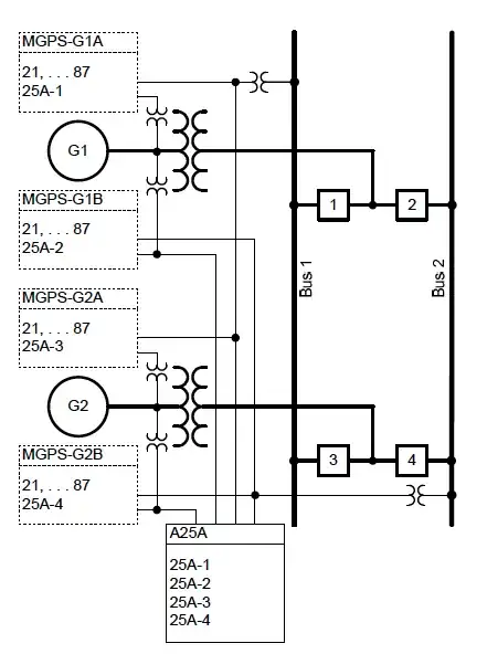

Common Modern Power Station Design
Here is my summary of what I believe to be the most common basic approach to modern power generation plant design. Figure and text adapted from:
"Fundamentals and Advancements in Generator Synchronizing Systems," Michael J. Thompson, Schweitzer Engineering Laboratories, Inc. Dec. 9, 2010.
In the figure...
  • Returns are not shown
  • G1, G2 are the generators
  • Squares 1,2,3,4 are relays
  • Bus1, Bus2 are out-bound power busses (redundant)
  • MGPS units are GPS-synchronized clock sources for timing the generators
  • A25A is the measurement and control unit (contains a microprocessor)
How it works...
Modern microprocessor-based components and "digital" timing gear, like synchrophasors, have revolutionized the way generator synchronizing systems are designed.
For example...
  1. The "A25A" in the figure is a microprocessor-based automatic synchronizer with six isolated and independent single-phase voltage sensing inputs that eliminates the need to physically switch voltage signals.
  2. The 1,2,3,4 "digital" relays provide streaming synchrophasor data.
  3. Relay-to-Relay communication in the A25A allows it to be located close to the synchronizing breaker with control signals sent back to the devices which slow down (governor) or speed-up (exciter) the generator mechanism via fiber-optic links.
Timing and Control...
The ability to build systems for monitoring and control using low-cost, fiber-optic communications links has completely changed generator synchronizing systems.
The "digital" relays take direct synchronized measurements. Synchronized phasor measurements are measurements of the phase angle of power system quantities relative to a universal time reference.
Today, the precise time reference required to make this phase angle measurement is easily obtained from protective-relay-grade Global Positioning System (GPS) satellite clocks.
Synchrophasor technology allows voltage readings from various devices throughout the power station to be compared for angular difference. The data can be streamed at rates up to 60 messages per second with low latency.
Since phasor measurement unit (PMU) functionality in protective relays was first introduced in 2000, they have become nearly ubiquitous, and synchrophasor data are available nearly everywhere at no additional expense to the power plant owner.
A dedicated computer, running synchrophasor data concentrator (PDC) software, can receive streaming data from the various microprocessor-based relays applied for protection and control of the synchronizing breakers.
Just as the microprocessor-based automatic synchronizer can select the appropriate voltages for each synchronizing scenario from those wired to its six input terminals, the PDC can select the proper signals in its incoming data streams for the incoming and running voltages based upon operator selection of the generator and breaker to be synchronized.
No physical signal switching is required. And the synchrophasor voltage measurements from the breaker control relays are independent from the measurements of the automatic synchronizer, which makes the systems redundant.
