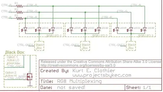

Hardware Considerations
To start, I am going to assume this is what you are trying to do:
RGB Multiplexing
There are three RGB LEDs. A single line controls each of the three internal LEDs, and this line is shared by the same color of each LED. Another control line is responsible for grounding these common cathode LEDs totaling six control lines in all. Only one RGB LED is on at a time, but the ground control lines are shuffled quickly enough that no one will notice. I have included a "black box" as the ground control because I don't know how you are sinking the LED current. If you go with Option 1, an I/O pin goes LO to sink the current for an LED. If doing this, remember that the total I/O pin current is 40mA, so each internal LED can only use (40/3) = 13mA. Option 2 overcomes this issue by using a transistor to sink the current (a BJT with a base resistor will work as well), however, this switches the control from active LO to active HI, driving the base/gate to sink the LED current though the emitter/source. A single Resistor can be used on each control line to limit the LED current since only one of the three attached LEDs will be on at a time.

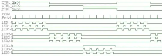

These are not the only ways (or best ways) to go about doing this, but they are just what I have used in the past with success. Whatever you do, this is the LED response you should expect:
RGB Multiplexing Signals
Notice each LED has its own duty cycle, but they all operate at the same frequency. Each RGB is only enabled 1/3 of the total time. You could also check your buttons inside of the pulse ISR. Just use another variable counter to create a 10ms timer (you mentioned 100Hz) inside of ISR A, similar to the timer used in the multiplexing ground control lines.
