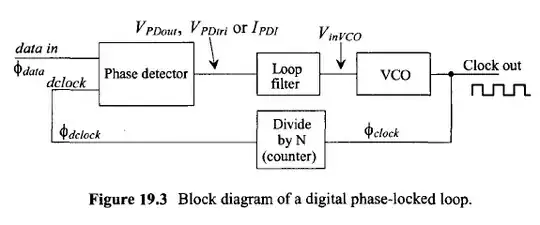

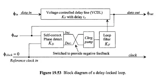

The key differences between PLLs and DLLs are:
1) PLLs extracts (locks on) both frequency and phase of the input signal. DLL extracts only phase.
2) DLL needs a reference clock. PLLs does not need a reference clock, instead it generates it.
3) PLLs uses VCO. DLL does not have VCO.
So, in a sense, one can say PLL is stronger than DLL because it can extract frequency of the data, not only phase. Assuming ideal reference clock present (the frequency of the data is known), DLL and PLL may perform the same function - aligning data relative to the reference clock present at the receiver. However, the way "the alignment" is performed is different. PLL varies frequency, while DLL varies delay (by adjusting current pumping transistor's capacitance inside VCDL).
