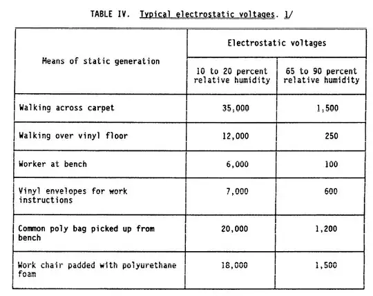

Table IV of Department of Defense Handbook MIL-HDBK-263B "Electrostatic Discharge Control Handbook for Protection of Electrical and Electronic Parts, Assemblies and Equipment (Excluding Electrically Initiated Explosive Devices)" lists typical electrostatic voltages generated in a facility as a function of humidity levels:
https://quicksearch.dla.mil/qsDocDetails.aspx?ident_number=53974 enter image description here
Clearly, less voltage is generated under humid conditions. This being said, humidity is not an indication of the risk of electrostatic damage to electronics, as stated in a note below the table "Caution should be exercised when attempting to correlate the above, or actual measured voltages with the potential to damage ESDS items." Note that ESDS is defined as "Electrical and electronic parts which have been determined to be ESD sensitive".

  • Interesting source material +1. One potential compensating factor is that humans tend to sweat more under high temperature and humidity conditions so the effective series resistance from a human finger touch may be quite a bit lower if the finger is wet with salty sweat. – Spehro Pefhany Oct 18 '23 at 18:29
