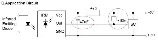

I think you refer to this diagram: -
The external pull-up is greater than 10k (note the ">" sign) - this means don't use anything equal to or less than than 10k - an open circuit is of course no problem.
The capacitor and 47 ohm resistor are there to improve noise immunity from the power supply. They probably aren't needed but the supplier is recommending them as a precaution
Andy aka

  • Any clue how noise might appear from the user's perspective? Wrong button reads? It's presumably not something you could fix in software like denouncing a button. – Jeff Burdges May 06 '13 at 11:38
    There is a high gain amplifier in there, so a low noise supply makes sense. If you're happy stabbing at buttons on the remote three times in the hope that it'll eventually work, you probably don't need the extra components! –  May 06 '13 at 11:39
