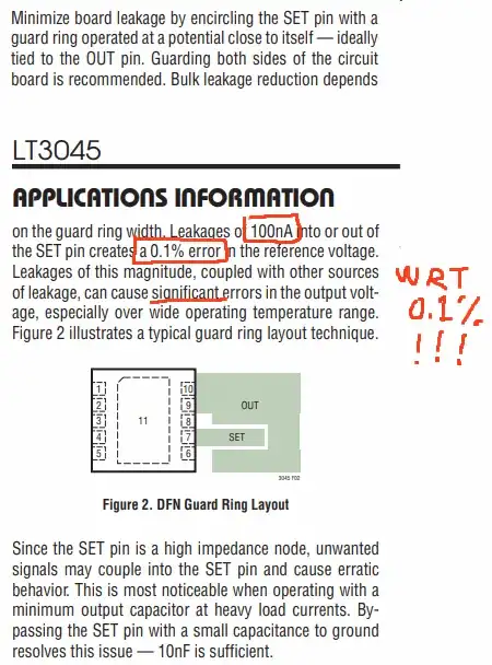

I am trying to follow the layout recommendations for this part, which is a high PSRR LDO.
For the SET pin, one can read the following (P.15):
Any leakage paths to or from the SET pin create errors in the output voltage... Minimize board leakage by encircling the SET pin with a guard ring operated at a potential close to itself — ideally tied to the OUT pin. Guarding both sides of the circuit board is recommended.
Then the manual goes on to show this image of a "guard ring":
First Question: where is the guard ring here, from this question, I thought it was supposed to be a ring of conductive material surrounding the pin we want to protect.

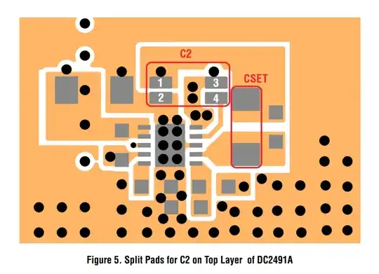

In the evaluation board the OUT pin does not even seem to surround the SET one (see following image):
Second question: Concerning the elusive "Guarding both sides of the circuit board is recommended" sentence: What does this mean and how do I do it? I don't see them doing it on the evaluation board...

From the datasheet:
Application information excerpt highlighted
100nA might be typical leakage of a contaminated PCB, say with mildly conductive flux residue, on a humid day.
0.1% accuracy is extremely precise as regulators go; with 1% initial accuracy, it will have to be trimmed to achieve finer precision, but presumably will be reliable (stable) thereafter.
Since from your comments, you have no critical performance requirements, then this consideration is not important and can be ignored.
As for why they didn't in the eval board, probably because it's an example, not a specific application. They also have control over the assembly, e.g. can specify suitable flux type, and washing to clean it. Whether the board remains as clean after its end users (design engineers) have made modifications, is entirely up to them [the users].
They may also simply only care about demonstrating the low noise performance, the absolute DC voltage of which doesn't matter.
