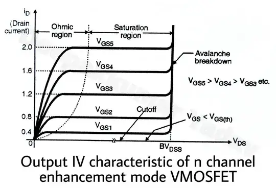

No, you cannot at all rely on this happening, especially as avalanching happens in the saturation region and not in the ohmic region: -
Image from here. The picture shows or implies that a particular MOSFET will always have the same avalanche characteristic but, it's highly dependent on temperature and gate voltage and the difference between individual devices means it's a totally unreliable feature to rely on.
So, with MOSFETs in parallel, one device becomes the sacrificial device and shorts the rest out (thus protecting them) and (hopefully) blowing a fuse. If the fuse doesn't blow but the MOSFET does (go open circuit), then the next MOSFET sacrifices itself. Do you see how this evolves?
