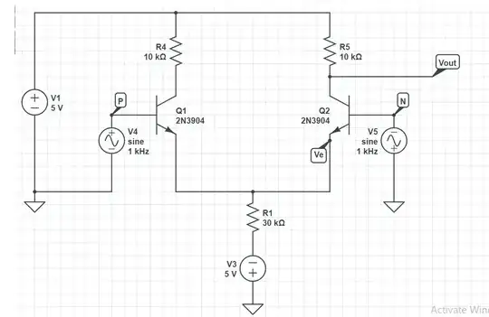

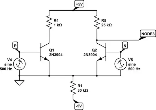

My other problem is recreating this circuit in circuitlab. I tried to build a similar one and understand better this way how the circuit works. The only problem is that...... the circuit behaves differently behind my knowledge of what goes wrong.
schematic

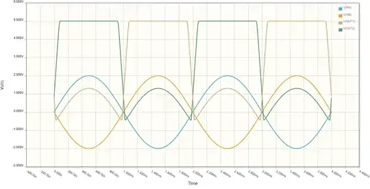

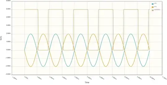

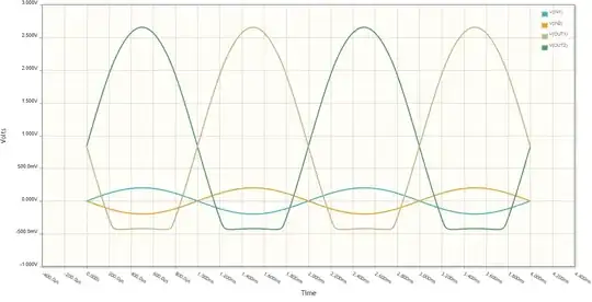

The differential amplifier transforms the sinusoidal inputs into some sort of cracky square wave. My first thought was that the amplitude of the voltage AC sources was too high and that the RMS voltage saturated the transistors for too long of a time. Nothing happened as expected once I made the modification. Then I reduced frequency and increased rail negative and positive voltage swings. I have modified the paramaters for resistance and the same result appears. I begin to believe that it is circuitlab's fault, but who knows? I sure don't. Oh and as a note, I have removed Re from both emitters as of lack of space on circuitlab. But this I don't think that should modify too much the linearity as circuitlab doesn't count for temperature change. What is the problem? Plese anyone explain. I understand the gain functions, I just do not understand how this circuit works and what is the problem with my reproduction of the circuit. Thanks!

    What you have simulated in circuitlab is not a differential amplifier. – G36 Aug 31 '23 at 15:25
    As soon as the voltage difference between the bases reaches more than a few hundred millivolts the BJTs are completely saturated out. Try using a very small signal difference, say no more than perhaps 30 mV difference one to the other and look again. The linear part of the arctan behavior only works over a small voltage difference range. The 2V peak sines, 180 degrees out of phase, will mean a difference of 4 V, at worst. Far, far too much. Of course the output looks like a square wave. I wrote something here. May help you understand. – periblepsis Aug 31 '23 at 15:27
  • Are the emitters of both transistors perhaps interfering in order for the difference to be amplified? the voltage at the emitters is proportional to base current, so perhaps the voltage differfence between the two emitters gives the result for the amplification?? – David Ab Aug 31 '23 at 15:27
  • @periblepsis I have used a minimum of 1 volt. Now I have ran again circuitlab and it does work with 30 mV. I would have never believed that only one volt was high enough to completely saturate the transistors. So after all my original hypothesis was right.... but too shitty of a performance coming from me when I simulated the circuit. Thanks! – David Ab Aug 31 '23 at 15:32
  • Try to read this about the working principle https://electronics.stackexchange.com/questions/336769/differential-amplifier-bjt-experimenting/336893#336893 and here maby as well https://electronics.stackexchange.com/questions/343833/differential-amplifier-biasing-problems/343845#343845 – G36 Aug 31 '23 at 15:32
    You need to remove the wire that connects the Q1 emitter with GND. Now you will have a diff amp. – G36 Aug 31 '23 at 15:36
    @DavidAb After you get the circuit properly in the simulator, you should find a behavior that looks about like this. I cobbled that up using a math plotter and I did NOT use the correct equations for it. But it gets the idea across. The x-axis is scaled with $V_T\approx 26:\text{mV}$ at room temps. You can see how narrow the linear region (plus or minus voltage differences between the bases) is. The y-axis is 1 for 100% of the current diverted to one side or the other. 0 is for 0%. Just FYI when reading it. – periblepsis Aug 31 '23 at 15:54
  • I have simulated the circuit correctly this time, and I have also measured the emitter voltages of both transistors in relation to the input signals. They correlate at the point of maximum amplitude and 0 voltage difference. It seems like the two voltages do intefere at the emitter of Q2, which get's amplified by G. I will post the results here. – David Ab Aug 31 '23 at 15:55
    It seems like the two voltages do intefere at the emitter of Q2 Not in an actual, symmetric differential amplifier :) If you put a mirror down the middle of the circuit, the other side should look identical save for different component references. In none of your schematics - be it in the question or in the "answer" - is that the case. – Kuba hasn't forgotten Monica Aug 31 '23 at 18:31

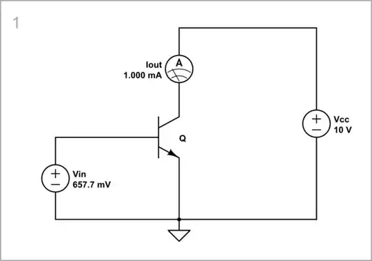

Common-emitter stage with grounded emitter and current output: A BJ transistor has a voltage input (base-emitter junction) and a current output (collector-emitter junction). The simplest way to drive it is to ground the emitter (Ve = 0 V) and apply the input voltage Vin to the base. Figuratively speaking, the emitter is "immovable" and we "move" the base.
schematic
In the CircuitLab simulation, open Vin's parameters window and, looking at the ammeter Iout, carefully set the input voltage (658 mV in the schematic) so that a (quiescent) current of 1 mA flows through the collector. This initial input voltage is known as a "bias voltage". You can then wiggle Vin around that value and watch Iout wiggle too around 1 mA.

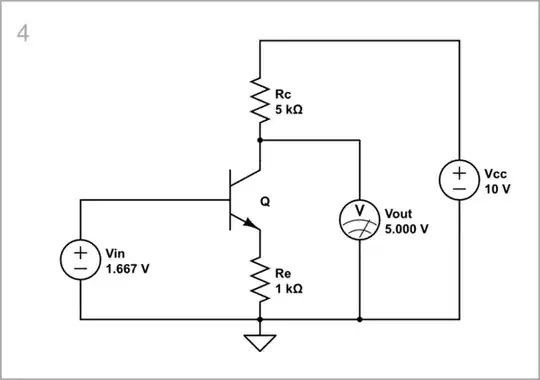

Common-emitter stage with a resistor in the emitter: If when, figuratively speaking, we "move" the base, the emitter also "moves" (in the same direction but with a smaller amplitude), the input voltage applied to the base-emitter junction and, accordingly, the gain decreases... as they say, because of the negative feedback aka "emitter degeneration". We can make the transistor do this by itself if we insert a resistor Re into the emitter (in place of the voltage source).
schematic
simulate this circuit

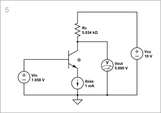

Common-emitter stage with a current source in the emitter: We can greatly enhance this effect almost zeroing the gain if instead of a resistor we include a current source Ibias or, more precisely, a current-stabilizing non-linear (dynamic) resistor. As a result, the emitter voltage will follow the input voltage exactly and the difference applied to the base-emitter junction will be zero.
schematic
"Hardened soft" emitter
So these are the rules:
  • If we want the transistor stage to amplify as much as possible, we must include a voltage source in the emitter.
  • If we want it not to amplify, we must include a current source.

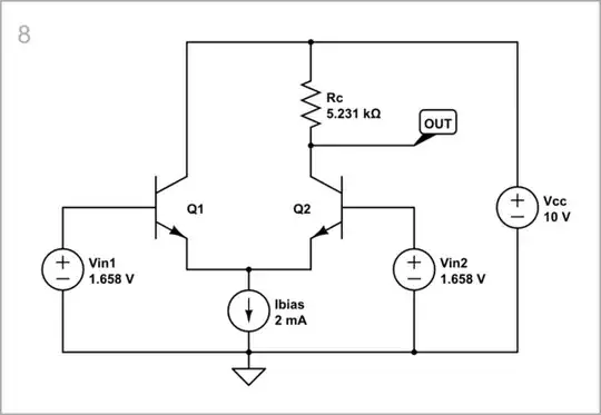

As a result, in the common mode, both base and emitter voltages will change equally and there will be no gain. If we stop the voltage from changing or start changing it opposite to the first voltage (differential mode), the gain becomes maximum.

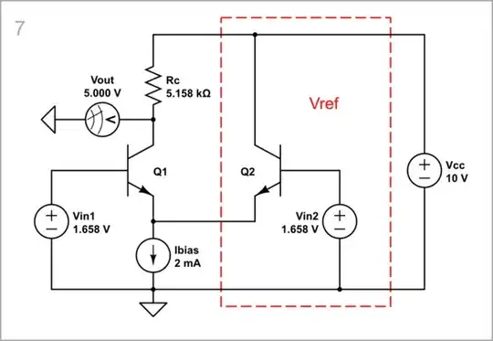

Now it remains only to draw the schematic more beautifully to get the classic "long-tailed pair".
schematic
Interacting voltage sources
But now we notice something even more interesting - the Q2's emitter is not only an output (of an emitter follower) but also an input (of a common-base stage). This is because the base-emitter voltage can be varied by both Vb and Ve (the so-called common-base stage). The same goes for Q1. So this is a symmetrical configuration where the two transistors interact (the OP's "interference").
Helping voltage sources (differential mode): When both input voltages change in the same direction, the common emitter voltage follows them, and the two interacting voltage sources "help" each other. Both base-emitter voltages and collector currents do not change; the output voltage also does not change, and the gain is zero.
Opposing voltage sources (common mode): When both input voltages change in the opposite direction, the emitter voltage does not change ("virtual ground"). The base-emitter voltages change with the maximum input voltage amplitude, collector currents change and the gain is maximum. Figuratively speaking, a kind of "tug of war" is observed where one transistor "pulls up" the emitters and the other "relaxes the pull" (at the same time the current source "pulls down" the emitters). Two "pull-up" elements (transistors) and one "pull-down" element (current source) are connected to the common point of the emitters.

Why emitter current source?
This is the second main point in this circuit that remains to be fully clarified. The problem is that the circuit has a differential input but we want its output to be "single-ended" (with respect to ground). A simple ohmic resistor with as much resistance as possible connected between the emitter and ground (or negative power supply) has somewhat solved the problem in the past (and in the H&H bestseller). But when the common input voltages and, accordingly, the emitter voltage Ve vary, the emitter current Ie varies accordingly to Ohm's law - Ie = Ve/Re. So the collector currents and the output voltage vary as well. The problem is because the emitter resistor is constant. If it was a "dynamic resistor" whose resistance increases when the voltage inreases and v.v., their ratio Ve/Re (the current) would stay constant. Accordingly, Ic and Vout would not change.
So, the common device between the emitters and ground (the circle with an arrow inside) is not a true current source (producing a current) but a constant-current dynamic resistor (setting the current). It is usually implemented by another transistor with a constant input voltage.

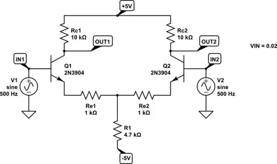

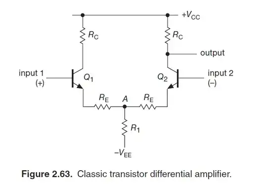

There's a couple of things. First of all, the circuit is not the same as that from Fig. 2.63. Both transistor's emitters are connected to ground, and the negative power supply does nothing besides dissipating power in R1.
Let's draw the actual circuit from Fig. 2.63:
schematic
The circuit must be symmetric to work as a normal differential amplifier.
Let's see how the outputs look for VIN = 2Vp-p, 0.2Vp-p, and 0.02Vp-p respectively:
enter image description here enter image description here enter image description here
Clearly, at 2Vp-p input the circuit has way too much gain for the output signal to fit between about -0.5V and +5V - the output range of the differential stage here.
At 0.2Vp-p we can see that the output waveforms clearly resemble the input waveforms, but the input voltage is still too large.
At 0.02Vp-p, we get the desired clean action of a differential amplifier.

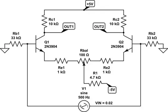

I have tested this on the bench, and the performance is very close to the simulation results. The transistors in my case were matched to have the same offset voltage to within 0.1mV and were super-glued together to maintain thermal bond. Both outputs have to be loaded the same - the circuit misbehaves if there's a scope probe connected only to one output, as that loads the collector of one transistor differently from the other. In the simulation everything in each half of the circuit is completely identical, so the bench model had to be as close as possible to that.
In a practical, easy-to-put-together breadboard variant you could use transistors without matching the V(be) offsets. Then, one of the AC sources would need to have its DC offset adjusted +/-20mV from 0V to bring the DC component of the output signal within the output range of the amplifier.

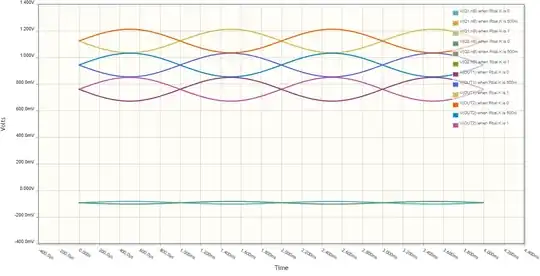

If the input was truly floating - no galvanic connection to the supply rails or ground, say a transformer winding - then the inputs could be self-biased, and the output offset could be nulled with a potentiometer in the emitter leg:
schematic
The outputs for Rbal at either extreme and the center position are:
Self biasing would be used for free-potential AC inputs - say if this was a differential amplifier front-end for a balanced XLR line audio input.
A simple floating AC source is a speaker, used in this case as a microphone. Works great as shown. Rbal may need to subsume more of the Re, so for simplicity you could have RBal=1kΩ, and Re1=Re2=499Ω.
Otherwise, the input potential common mode would be expected to be within the operating range of the input stage. For a stage with resistive collector and emitter loads, the gain varies with common mode, so that usable common mode range is narrow. For a stage with current source emitter load and a current mirror collector load, the gain is much higher and has less dependence on the common mode voltage, but much higher dependence on temperature. Thus, such high-gain input stages only make sense when negative feedback is available to control the gain - as is the case in an op-amp, for example.

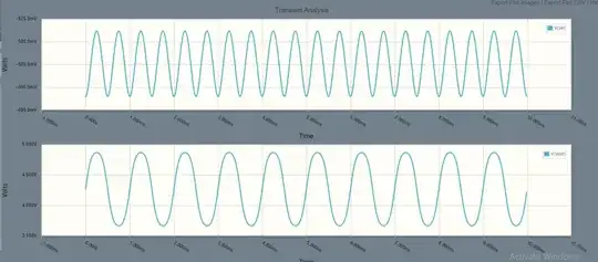

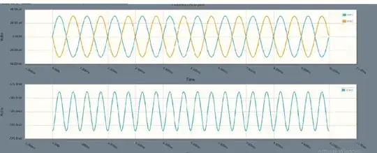

I got the circuit right and now I have tested my hypothesis with the interference between the two voltages at Q2's emitter. enter image description here
Again this is the modified amplifier with .03V amplitude at the input base of Q1 and Q2, and with the ground detached from the emitters of the transistors (it mostly disturbed the linearity, opsie doosy). And now I have plotted the voltage at the bases versus the voltage at Q2's emitter.
where Vp and Vn are the voltages at the bases and Ve is the voltage at the emitter of Q2. It seems like the voltages of the transistors do interfere at the emitter, and that it get's amplified as a result of the voltage difference. Now let's plot Ve versus Vout (at Q2's collector) and see what happens
the voltage entering q2 get's amplified by the respective voltage gain, as described by a differential amplifier. the difference of voltages at Q2's emitter between Vq1 and Vq2 get's amplified by G and the resulting voltage is observed at Q2's collector. If we would merge the two collectors together to see their respective voltages we would get a higher amplification resulting from the difference of the two Vcollector voltages. From all the gathered infromation I will state this as the final answer. Any other additional comments are welcomed.Thanks!

    This does not look like an answer to the question, or perhaps as a bad answer, and the circuit you show is still misbehaving. A low gain differential amplifier is linear enough all by itself so that the outputs look "just like" the inputs, with no discernible distortion. If the input is a sine wave, the output should be a sine wave as well. R4 and R5 should be identical. The whole thing must be symmetric, otherwise it won't work well. – Kuba hasn't forgotten Monica Aug 31 '23 at 18:22
    Note: it's possible to declutter the schematic by naming nodes with desired voltages. E.g. a node named "+5V" or "+5.0V" has a 5V potential relative to the GND node, and so on. That way the supply sources don't obscure the relatively simple circuit. – Kuba hasn't forgotten Monica Aug 31 '23 at 18:29
  • @Kubahasn'tforgottenMonica in the circuit I forgot about the collector resistor of Q1. I modified it after I have taken the screenshot when I noticed the distortion (sorry about that). I was more interested in seeing how the signals behave rather than their distortion. I am aware of the importance of linearity, I just didn't give much importance to it at the moment when this picture was taken as my question clearly asks "what is the basis on which the circuit works" (or something like this). Still thanks (for the answer as well). – David Ab Aug 31 '23 at 18:46
