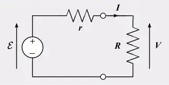

The battery can be modelled as shown here:
As you can see, the battery can be modelled with an ideal battery and internal resistor in series (r). The LiPo batteries have a very small internal resistance. For two batteries with different levels of charging, the voltage of the batteries is different. If you connect two of these batteries with different voltage levels, you will end up with two voltage sources that are connected via a very small resistor. This will create a very high current from the battery with higher voltage to the battery with lower voltage.
If this current exceeds the maximum charging current of the battery with a lower voltage or the maximum discharge current of the battery with a higher voltage, the battery will be damaged. To be able to connect these two batteries, you need to make sure there is a big enough resistor between them to limit the current within the maximum rating of the batteries. Such a resistor should have enough power to be able to dissipate the power going through it and it might get hot (depending on the switching time).
