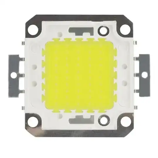

I am using this 50 watt high power LED:
50 W high power led.

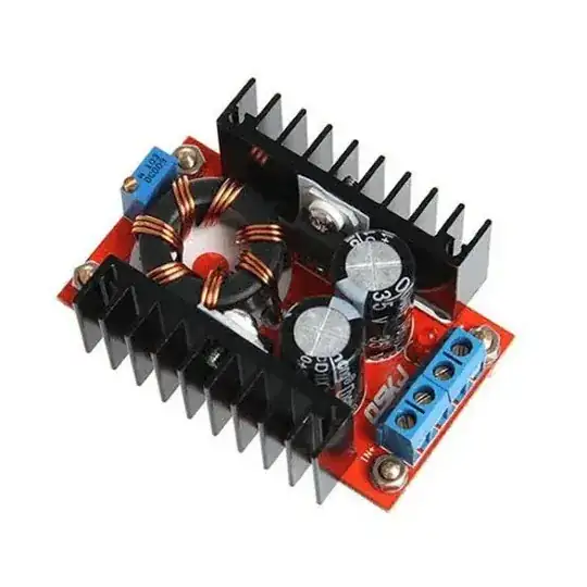

And want to power it using this voltage booster:
12v to 34v step up voltage booster
From 12 V to 34 V as the requirements of the LED datasheet.
  • Will it work?
I read that I need to limit the current because the current will burn it.
  • Doesn't the LED take just what current it needs from the power supply? How can the current burn it?

You need to keep the LED current (and temperature) below its rated values for it to survive.
That voltage booster appears to only have 1 pot, so it likely works in constant voltage mode only. Some can work in constant current mode.
The LED current will increase with voltage very steeply, but you CAN control the current by adjusting the voltage while monitoring the current with a multimeter.
The downside to doing this is that the current will vary considerably as the LED temperature changes.
It's fairly common for boost converters like this to have a constant current mode (it will have 2 adjustment pots). Using that mode is preferable for driving a LED.
