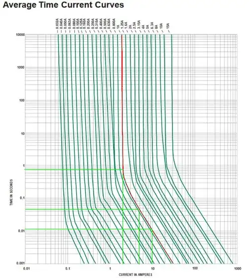

Typicla fuse time to blow curves for a fast blow fuse family.
I've highlighted the 1 amp fuse curve and added a few intercept points to show the blow times at various currents.
Note that current is the only parameter considered. (In practice ambient temperature and air cooling can have a minor effect.).

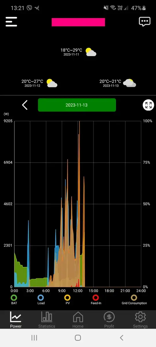

As an example, see this image showing 25A fuse blown to disconnect a 240V load when drawing power at about 9.2kW, which should have blown at 6kW (if you do the math). Voltage spikes were transient and not persistent long enough to heat up the fuse to melting point.
load power graph
Notice the gap during which no power was being supplied until new fuse replaced and power reset at under 6.9kW
