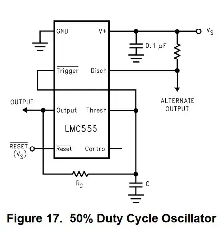

This datasheet shows on page 16 figure 17 a special circuit for 50 % duty cycle.
Note that this circuit is for the LMC555 and might not work with the NE555.

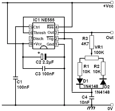

NE555 is the part number for the original bipolar version of the chip. The standard astable circuit you posted cannot achieve a true 50% duty cycle as shown. There are several versions of the same technique to achieve this, involving diodes to completely separate the charging current from the discharging current. Here are random innergoogle grabs as examples:
There are two problems with the bipolar 555 for this application. one is that it has an asymmetrical output impedance. The other is that the high and low output voltages are not spaced identically between the voltage rails. IOW, if the part is running on 12 V, the high output voltage is not as close to 12 V as the low output voltage is to 0 V.
The CMOS 555 (National's is the LMC555) does not have the standard 555's extra-beefy output stage. What it does have is a much more symmetrical output, so you can come very close to a true 50/50 output waveform without the diodes and adjustment. It also has a much higher operating frequency range so a clean, square 100 kHz output is not a strain for it to produce.
