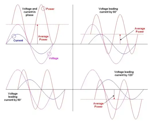

An instantaneous power waveform is produced by the multiplication of the current and voltage waveforms. A few examples of what I mean from here: -
If you then average the power waveform you get the average power consumed per phase.
The three average power values (from each of the three phases) can be summed to give you total average power into your load. Average power is what you are generally billed on.
