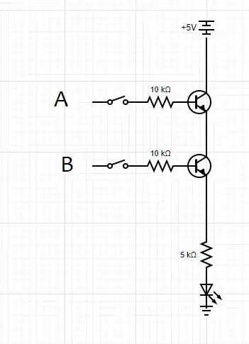

I'm building an AND gate out of transistors. Knowing how the basics work, I built my own (naive) circuit using the following design.
Simple 2 transistor circuit
In testing, it didn't work like an AND gate.
A B LED
0 0 Off
1 0 Off
0 1 Weakly on
1 1 Strongly on

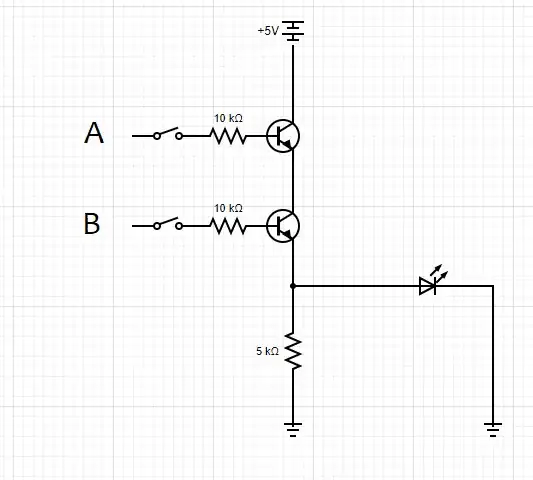

I googled around the internet, and found another circuit that had two grounds.
better and gate with transistors
In testing, it worked like I'd expect an AND gate would. The LED only shining when both A and B are pressed. But if either were off, the LED was dark.
Why was the second ground needed to make my AND gate function correctly?
For my first circuit, when A was off and B was on, where was the current/voltage to power the LED (weakly) coming from? Since the path from +5v to ground was (seemingly) blocked by transistor A?

In your first circuit, when A was off and B was on, the LED is weakly ON because of the base current of the BJT (flows from base to emitter to the LED).
In your second circuit, when A was off and B was on, the 5k resistor provides the path to the base current; provided it was designed such that the voltage across the 5k resistor is less than the diode cut-in voltage. This is the advantage of the second circuit which cuts off the LED current for this scenario provided the resistor values are designed correctly.
P.S: Note that the second circuit has only 1 ground. The correct terminology to use to describe it is that the 5k resistor and the LED are in parallel here.

  • So the BJT transistor "leaks" some current through the emitter when the base is on? (excuse my terminology if that's not the correct to describe it)
    Okay, I had assumed no current flowed from the base to emitter. Thank you for your answer.
    – Morgan Kenyon Aug 03 '23 at 02:10
    Base-emitter is a diode. So, when base-emitter voltage is higher than the cut-in voltage, a base-emitter current will flow. – sai Aug 03 '23 at 02:12
    @MorganKenyon You misunderstand how a BJT transistor operates: the BE potential difference causes current to flow through the emitter, but most of that current usually travels right through the base and gets sucked up by the collector instead, leading to current amplification because the BE voltage causes much less actual base current than collector current. If the collector is disconnected, all of the emitter current does go through the base. Or viewed the other way round: the base current is not amplified but instead is identical to the emitter current. – user107063 Aug 03 '23 at 11:56
  • @MorganKenyon All of the base current must go somewhere. It has two choices: collector or emitter. Given that the emitter is at the lower potential, it flows there. That transistor doesn't leak "some" base current. It has to "leak" all of it. If a current flows into a box, it must flow out of that box on some other terminal, or the currrent wouldn't flow to start with. – Kuba hasn't forgotten Monica Aug 04 '23 at 18:05
  • @MorganKenyon So the BJT transistor "leaks" some current through the emitter when the base is on? In a MOSFET, the gate is insulated and the transistor is controlled by a voltage alone. In a BJT, the base is not insulated and it always looks like a diode. To control the BJT, you must "push" a small current into it. Since bipolar logic is largely obsolete, most digital logic books are written with MOSFET in mind, not BJT. If you want to go retro and learn the basis of bipolar logic, a good book is the RTL Cookbook from the 1970s. – 比尔盖子 Aug 06 '23 at 00:21

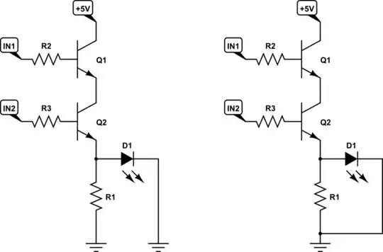

There is no "second ground". The ground symbol is a way of de-cluttering schematics. When you see the same symbol used in multiple places in a schematic, they are indicating the same electrical connection, or "node". The ground node has so many connections to it (perhaps hundreds) that a dedicated symbol is used instead of many of connection lines to a single point, which would make a schematic very difficult to read and understand.
We interpret that symbol to mean that it is physically connected to every other point in the circuit with the same symbol, and it is declared to have zero volts (0V) of potential. Every other node's potential in the circuit will be measured and quoted with respect to this "ground" reference point.
It is possible to have multiple independent grounds in a single circuit, but they will each use their own symbol to distinguish them from the others, such as these:
In your circuit, there is only one electrical node in the circuit which we call "ground" or zero-volts, because there is only one ground symbol repeated twice. They both refer to the same point in the circuit, because they are the same symbol, and they are physically joined with wires or PCB traces or other conductive path. These two circuits are identical:

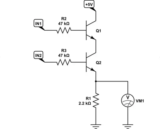

schematic
The above circuit (which is your second design) is bad, and can damage the LED or transistors. When both transistors are on, LED D1 will effectively be connected directly across the power supply, with nothing in the loop to limit current. Your first design is better, since current is always constrained by the 5kΩ resistor.

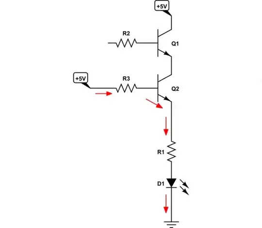

It's still not great though. The base-emitter junction of a bipolar junction transistor (BJT) behaves just like a diode (because that's what it is). In your schematic, when the lower input B rises in potential, that transistor will conduct current entering via its base, and leaving via the emitter, regardless of the state of the upper transistor:
schematic
simulate this circuit
That means a high input at B, to the lower BJT in your schematic, will cause the LED to glow regardless of the state of the upper transistor, which is not ideal if you are trying to implement an AND gate. It still amazes me that people publish this design claiming that it will work as an AND gate. It nearly does, and I suppose it illustrates the working principle of an AND gate, but it is a deeply flawed design.
It can be made to work, but one must take great care to ensure that base current is very, very small, compared to load (LED) current that would flow if both transistors were switched on. That is, R2 and R3 should be much greater than R1, greater by a factor of at least 10. Just be aware that an LED will glow even if the current through it is mere microamps, and therefore doesn't make a very good indicator of "on" or "off" state in this application. The circuit would work, however, with careful choice of resistor ratios. I recommend that you determine output state by measuring output potential (with respect to ground), instead of using an LED:
schematic
