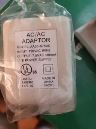

I need to replace this 20+ year AC/AC 7.5VAC (4.0MM x 1.7MM FEMALE) adapter, but can not find it anywhere. I'm looking for advice on what may work in its place, or if there's a way to bypass it altogether to provide power in a different way.
Also, I did find a 7.5VAC AC/AC wall transformer plug, but with only 300mA and the wrong sized connector tip.... would the 300mA work if I can figure out a way to switch the connecter?

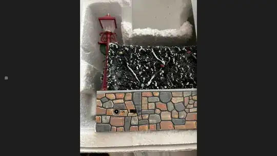

EDIT: thanks everyone. The adapter powers an older dept56 christmas village animated piece.

  • What is it powering? That's an uncommon voltage so if there's some flexibility that might be helpful. – user1850479 Jul 25 '23 at 18:13
  • 300mA might work - if the existing adapter is oversized for its application. What are you powering with it? – brhans Jul 25 '23 at 18:14

Buy any AC transformer that fit your needs without considering the connector (try to take one identical or with a slightly higher current). Then either find the right barrel jack or cut the old one with some wire and install it on your new transformer.
