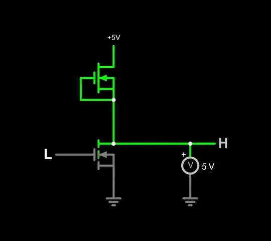

The 'thick' FETs are depletion-mode type. In NMOS devices they are typically used in the pull-up network instead of resistors.
To model their behavior in the 6502 you could replace them resistors, with some reduction in efficiency. Otherwise you'll need to source some depletion-mode n-FETs (rare these days, but not impossible.)
More about depletion-mode FETs: Typical use of depletion MOSFET
How does the depletion-mode FET work as a pull-up? Here's a simulation showing the principle in an NMOS inverter (simulate it here):
(The depletion-mode FET shown has a threshold of -0.5V.)
It might also be possible to convert all the NMOS gates to CMOS topology. This will increase your transistor count on the pull-up side, but it will use less power than NMOS (or NMOS faked out with resistor pull-ups.) Note that the 6502 uses a lot of common pull-ups to implement PLA's, so this may not be practical.
