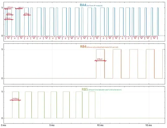

To be able to receive any data correctly, I have to know how long it takes for a "bit" to be completely sent (that is, one high pulse followed by a low pulse). That's why I first have to "sync" the uC and then I can start decoding data.
As you can see in this graph, the output at RB4 is a pulse of 876 μs, where instead, it should be a pulse of around 670 μs (matching the bit period). Now, one "debug" feature is the output at RB5. It (should) only change state when a full "bit period" has passed while in the sync time. And luckily it does. Watching it on the photo might be hard, but with the raw data I can see that the pulses (high or low) generated at RB5 are all around 650 to 700 μs (because the timer2 interrupts every 50 μs), and adding them all and averaging them, I get really close to the actual bit period.

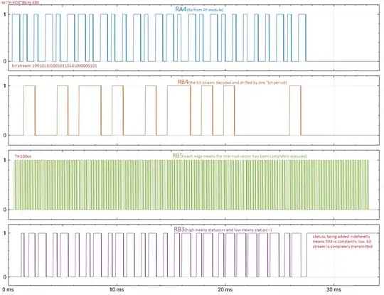

void __interrupt() isr() { if (PIR1bits.TMR2IF) { status = PORTAbits.RA4; if (status) { if (!statusp) { if (statusc > 0) { //0 PORTBbits.RB4 = 0; buffer[count] = 48; } else { //1 PORTBbits.RB4 = 1; buffer[count] = 49; } statusc = 0; count++; } statusc--; PORTBbits.RB3 = 0; } else { statusc++; PORTBbits.RB3 = 1; } if (statusc > 45){ done = 1; } statusp = status; PIR1bits.TMR2IF = 0; PORTBbits.RB5 = !PORTBbits.RB5; } }
As you can see, I did some modifications and added some other debug stuff because the way I was "debugging" the variables was completely useless.

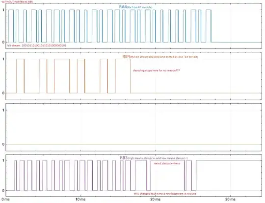

Now, as is, the code works really good at reading only the first bit stream (the remote repeats the same code 6 or 7 times). Only the last bit gets lost, but it dosent really matter because is considered as an "anti-code period" by the datasheet. The issue is that if I remove the last line of the interrupt (PORTBbits.RB5 = !PORTBbits.RB5;) EVERYTHING stops working. And I really mean it. The bit stream gets corrupted, the edge detection stops working and the end detection (done) triggers before the bit stream ends. The thing is that I need that line to be gone, since in the full code (wich I still havent tested any of what I did on) I use that pin for other things, and there are no spare pins. It would seem like the issue has to do with the overall time it takes for the interrupt to complete, but it wouldnt make any sense because a simpe PORTX = X (if i'm not mistaken) takes only 4 cycles, and if the INTOSC is at 4MHz that means that PORTX = X takes only 4uS. What is even more weird is that in theory, after the interrupt ocurrs (again, if I'm not mistaken), that is, TMR2 == PR2, it "automatically" clears TMR2 and starts counting again even if the interrupt vector isn't completely executed yet. I dont know. I attach these two images of the outputs i have when the PORTBbits.RB5 = !PORTBbits.RB5; line is on the interrupt and when its not: enter image description here enter image description here Over here I made another question with more info about this issue.

I forgot to add CMCON = 0x07 to turn off the comparators. That did the trick.
The issue has to do with problems with the read-modify-write (RMW) behaviour of BSF/BCF instructions on PORTx registers in old PIC16F devices.
