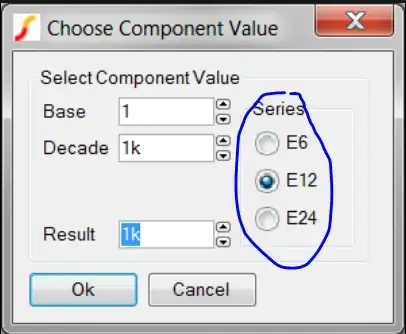

Can someone tell what is the meaning of the circled item in Simetrix for a resistor?

These are standard resistor series. Each E series has slightly different values in them. There are more than just these shown, in fact, there is E3, E6, E12, E24, E48 & E96
The number tells you how many values there are in each decade. So E3 will have 3 values per decade and E48 will have 48. Usually, the lower the number, the lower the tolerance range too.
The standard EIA values in a table can be found HERE, along with an explanation.

  • Thank you for the answer. Can you tell how is it relevant in a simulation? – Freshman Jun 19 '23 at 11:39
  • Irrelevant. The relevant part is the resistor value – MCG Jun 19 '23 at 12:00
  • Ok. Thank you for confirming the E series value is irrelevant for the simulation – Freshman Jun 19 '23 at 12:16
    @Freshman that's not what MCG said. The resistor value will be chosen from the E-series you select. – Marcus Müller Jun 19 '23 at 12:50
  • Yes, perhaps I should have been clearer. The E series value doesn't make a difference to the simulator. 1k will be 1k. However, when selecting a resistor value, using the E6 series will give you significantly less choice. So the E series is irrelevant to the way the simulator will simulate the circuit, but it is relevant for selecting a value. – MCG Jun 19 '23 at 14:08
  • Can you please explain what you mean by "will give you significantly less choice" ? – Freshman Jun 19 '23 at 14:54
  • @Freshman If you chose E6, and stick with the 1k decade, you will have choice of: 1k, 1.5k, 2.2k, 3.3k, 4.7k & 6.8k. If you selected E12, you'd get 1k, 1.2k, 1.5k, 1.8k, 2.2k, 2.7k, 3.3k, 3.9k, 4.7k, 5.6k, 6.8k & 8.2k. Your choice of values have doubled. That's the significance of the E value, as described in the link from my answer. But choosing 1k in E6 makes no difference to the simulator as a 1k from the E12 series – MCG Jun 19 '23 at 15:00
