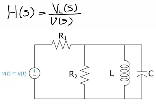

I'm trying to obtain the transfer function which relates the input voltage with the inductor's voltage H(s) = Vl(S)/U(s) H(s)=V_L(s)/U(s)

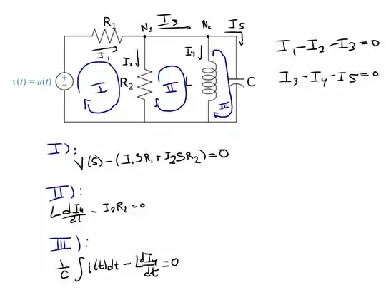

so far I've tried to use Kirchoff's Laws in order to find it. Any suggestions? I'm not familiar with this circuit so much so I'm trying to get as much info as possible. Thank you. enter image description here Edit: tried: enter image description here Edit: Vl/V(s): enter image description here

  • Do you know how to apply KCL (nodal) to this problem? I see loops for meshes. So I'm just curious. One potential simplification, if you wanted to go that direction, would be to convert the voltage source and R1 and R2 into a single, different voltage source and a thevenin equivalent resistance. That would remove one part and simplify things, slightly. – periblepsis Jun 17 '23 at 23:44
  • Would that mean converting R1 and R2 into it's equivalent resistance using V(t)*R2 / (R2+R1)? – Izanami Jun 17 '23 at 23:50
  • Well, the thevenin voltage source would look like that, yes. Not the resistance. – periblepsis Jun 17 '23 at 23:52
  • Yes. But if I want to get the equivalent resistance wouldn't it be just R1+R2 since they are in series? – Izanami Jun 17 '23 at 23:54
  • No, the thevenin resistance (series) would be R1 parallel to R2. (It's possible that you are out of your depth on this one.) I believe the answer should be $\left[\frac{R_2}{R_1+R_2}\right]\cdot\left[\frac{\frac1{C_1,\cdot,\left(R_1,\mid\mid, R_2\right)}s}{s^2+\frac1{C_1,\cdot,\left(R_1,\mid\mid, R_2\right)}s+\frac1{C_1,L_1}}\right]$. (Only spent a moment on it, so I may be in error.) But I fear you aren't ready to get there. Note the use of parallel for R1 and R2? That's the thevenin resistance in play. – periblepsis Jun 17 '23 at 23:55
  • I'm afraid I'm not. I'm trying to get each loop's KVL and KCL as my edit suggests, but I think, per what you are suggesting, I'm going the wrong way. – Izanami Jun 18 '23 at 00:01
  • I can show a way. I'll try and keep it to the basics. I just hope it helps. Before I try, is there something special about u(t)? It is common to use that as a unit step function. But does it have that meaning here? It matters. – periblepsis Jun 18 '23 at 00:02
  • Well. I got to use it later to indicate (with certain R, L and C values) its damping, but I'm unsure if we need to use it as the unit step function in here. I, so far, don't know why, if I'm looking for the inductors voltage, we need to use it as u(t) – Izanami Jun 18 '23 at 00:09
  • Does $\frac{V_{\text{L}}-V\left(s\right)}{R_1}+\frac{V{\text{L}}}{R_2}+\frac{V{\text{L}}}{s,L_1}+V{\text{L}}s,C_1=0$ make sense to you as a KCL expression? (Think of 1/s as an integral sign and just s as a d/dt thing.) In the time domain, this would be $\frac{V{\text{L}}-v\left(t\right)}{R_1}+\frac{V{\text{L}}}{R_2}+\frac1{L_1}\int V{\text{L}},\text{d}t+C_1\frac{\text{d}}{\text{d}t}V{_\text{L}}=0$. – periblepsis Jun 18 '23 at 00:28
  • Okay, yes, it makes sense – Izanami Jun 18 '23 at 00:31
  • Then just solve the first one for $V_{_\text{L}}$ in the usual algebraic way. What do you get? (Once you get it, just divide by $V!\left(s\right)$, of course.) – periblepsis Jun 18 '23 at 00:32
  • After dividing by the source I get something like this: l1*r2*s/(c1*l1*r1*r2*s**2 + l1*r1*s + l1*r2*s + r1*r2). (Also, I'm just curious. How comfortable are you with the terms: homogeneous equation, non-homogeneous equation, and annihilator methods?) – periblepsis Jun 18 '23 at 00:44
  • I'm sorry, I've been trying to solve it but I'm just in a dumbloop right now. And yes, I am familiar with those terms – Izanami Jun 18 '23 at 00:49
  • Okay. I'm in no rush. Take your time and get through the algebra. I've provided something to compare with. Not the best form (there are some 'standard' ways to write it that are more 'informative'.) But good enough to check your work. (You could just start by multiplying both sides by r1*r2*l1*s for example, and then cancel terms and move things around, after.) – periblepsis Jun 18 '23 at 00:53
  • Thanks, I'm sorry again, I took a whole lot of time, but there it is. I edited the main question* – Izanami Jun 18 '23 at 01:01
  • R2, L, and C are in parallel. Use the Laplace equivalents for these components to express them as an impedance. Then use the voltage divider rule. Also , note that these three components have the same voltage across them, so there’s no value in trying to separate them. – Chu Jun 18 '23 at 01:03
  • I'm afraid I'm not following you @Chu. I've tried but I got:
    $ u(s) = I_{1}(s)R_{1} - I_{2}(s)R_{2} - I_{3}(s)+I_{4}(s)Ls+ \frac{I_{5}(s)}{Cs})$
    – Izanami Jun 18 '23 at 01:20
I can't write this in a comment and it seems worthwhile to perform the algebra steps I took:
$$\begin{align*} \frac{V_{_\text{L}}-V\left(s\right)}{R_1}+\frac{V_{_\text{L}}}{R_2}+\frac{V_{_\text{L}}}{s\,L_1}+V_{_\text{L}} s C_1 &=0 \\\\ \frac{V_{_\text{L}}}{R_1}+\frac{V_{_\text{L}}}{R_2}+\frac{V_{_\text{L}}}{s\,L_1}+V_{_\text{L}} s C_1 &=\frac{V\left(s\right)}{R_1} \\\\ s R_1 R_2 L_1\left[\frac{V_{_\text{L}}}{R_1}+\frac{V_{_\text{L}}}{R_2}+\frac{V_{_\text{L}}}{s\,L_1}+V_{_\text{L}} s C_1\right] &=s R_1 R_2 L_1\left[\frac{V\left(s\right)}{R_1}\right] \\\\ s R_2 L_1V_{_\text{L}}+s R_1 L_1V_{_\text{L}}+R_1 R_2 V_{_\text{L}}+s^2 R_1 R_2 L_1 V_{_\text{L}} C_1 &=s R_2 L_1V\left(s\right) \\\\ \left(R_1 R_2 L_1 C_1 s^2 +s R_2 L_1+s R_1 L_1+R_1 R_2 \right)V_{_\text{L}}&=s R_2 L_1V\left(s\right) \\\\ \therefore \frac{V_{_\text{L}}}{V\left(s\right)}=\frac{R_2 L_1 s}{R_1 R_2 L_1 C_1 s^2 +\left(R_1+R_2 \right)L_1s+R_1 R_2} \end{align*}$$
You could just stop here. But there's a few standard forms for a bandpass like this that provide a little better information.
The first thing you'd want to do is to find that \$\omega_{_0}=\sqrt{\frac{b_0}{b_2}}=\sqrt{\frac{R_1 \,R_2}{R_1 \,R_2\,L_1\,C_1}}=\frac1{\sqrt{L_1\,C_1}}\$ (I use zero, not 'c' or 'p'.) You may want to highlight that fact in the resulting equation, somehow. (Yeah, \$b_2\$ is the coefficient for \$s^2\$, etc., in the denominator.)
The next thing you'd want to do is to find either the damping factor, \$\zeta\$, or else the \$Q\$. (Note: \$\zeta=\frac1{2 \,Q}\$.) It turns out that \$\zeta=\frac12\frac{b_1}{\sqrt{b_2\,b_0}}\$. (You can get \$Q=\frac{\sqrt{b_2\,b_0}}{b_1}\$, too.)
Then some standard forms are:
$$\begin{align*} \underbrace{\overbrace{K}^{\text{gain}}\cdot\overbrace{\left[\frac{2\zeta\,\omega_{_0}s}{s^2+2\zeta\,\omega_{_0}s+\omega_{_0}^{\:2}}=\frac{\frac1{Q}\left(\frac{s}{\omega_{_0}}\right)}{\left(\frac{s}{\omega_{_0}}\right)^2+\frac1{Q}\left(\frac{s}{\omega_{_0}}\right)+1}\right]}^{\text{standard bandpass form}}}_{\text{standard bandpass form with gain}} \end{align*}$$
To get it into that form, you need to wrestle with the numerator in order to split it up into the \$K\$ part and the \$\frac1{Q}\$ part (or \$2\zeta\$ part.)
\$\zeta\$ might be preferred over \$Q\$ when \$Q\le 1\$ with \$Q\$ preferred, otherwise. It's a matter of what shapes are of more concern, which may be picked out.
But you may be able to get away with any correct form and don't need to find standard forms.
