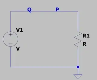

As far as I understand, you need potential difference to draw current.
Assuming ideal conditions, we can state that there is no resistance in the path, and therefore the potential difference between the resistor R1 is V1. This potential difference results in a current of V1/R amperes flowing through the circuit. If there were no potential difference, the current would be 0/R amperes, which is equivalent to 0 A.
What I don't understand is this:
I marked two points on the path, P and Q. Assume ideal conditions with no resistance in the wire. In such a scenario, there should be no reason for the potential to drop between P and Q. If there was a potential drop, it would indicate the presence of some resistance, contradicting our initial assumption. Consequently, we conclude that P and Q are at the exact same potential.
What confuses me is how there can be any current flow between P and Q when there is no potential difference between them. I am aware that this model is an oversimplification and represents an idealized scenario. I am not questioning the real-world implications; instead, I am specifically asking about the occurrence of current under these ideal conditions and how it manages to pass through in order to reach the load. How is this explained in the theory itself?
EDIT
I want to clarify something:
People have been saying that P and Q are actually the same point in space, so there cannot be any current between them (no area, no current; makes sense). This might be the explanation from a circuit theory point of view. However, Ohm's Law doesn't state that. People have also been saying that Ohm's Law defines current in a non-zero resistive path (which I've never seen as a constraint in Ohm's Law before). If we include that condition, then we are good. Otherwise we have a problem. Any theory (whatever it may be) should be valid within its realm of validity (otherwise, it is logically contradictory, let alone mathematically). Can you think of any violation of Newton's Law or any place where Newton's Law cannot explain the phenomenon under sufficient assumptions and within the realm of its validity? I don't think so. The same must be true for Ohm's Law. As far as I know the law, there is nothing that lies outside the definition of the law. There is a resistive path with zero resistance, a load, and a voltage source, so tell me the current between these two points? Better question is "Why is there a current between these two points? Can your theory explain that?" People have also been suggesting checking out superconductors (which are fun and I like them), but I don't think that answers the question.

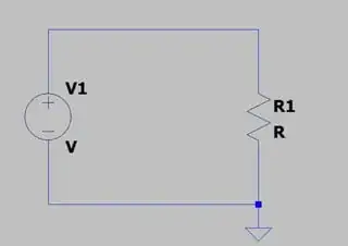

If you are talking about an ideal schematic, ideal circuit theory, then P and Q are two co-incident points on the same node, there is no wire between them. The V1 +ve terminal and the top of R1 are also points on the same 'top wire' node.
An ideal node is an equipotential connection between ideal components, which has no size itself. It just conveys any current entering from any one connection to any other, while obeying Kirchoff's Law that charge doesn't build up on a node.
We just connect points on the node with 'wires' for drawing convenience, so that everything doesn't end up on top of everything else.
If we did want to model a real wire between V1 and R1, then we would give it some finite resistance, and then V1 and R1 would be connected to two separate nodes, connected by the wire's resistance.
So there is no wire PQ, there is no spoon.
If, on the other hand, you want to talk about reality, split that top node, and place a real wire between P and Q, then it's a different argument.
The problem is with your expectation that you need a potential difference to have a flowing current. That's false. Just look at superconductivity, charge flows along a wire without any voltage drop.
Resistance is just a description of what we observe. We see a current in a wire, we measure the voltage drop between the ends. The ratio we call resistance. If it's a small voltage drop, then we say the resistance is low. If it's a zero voltage drop, then the resistance is zero.
That relation is often inverted to say that current = voltage/resistance. That's useful when resistance is finite, which is the case when superconductors aren't around, and reasonably useful when resistance is more or less constant, as in metals, 'resistors' etc, but crucially not useful in diodes and other non-linear components.
What 'makes' the current flow? In a real world wire, starting from zero, we would need an initial voltage, to get a rate of change of current through the wire's inductance. Once the current is flowing steadily, zero rate of change, zero volts is needed across the inductor. Now we see whether a voltage is needed across the resistance of the wire to keep it going.
Yes this is true, but a potential difference is not required to pass current. Water in a river can pass through a horizontal section of the river where there is no change in height (potential difference) where it is being pushed by the water from upstream that does have a change in height.
This is not true in general, but is true for a load on a voltage source.
Ohm's law states that \$I=V/R\$. If \$R=0\$ then the result is undefined, although some might say the current approaches infinity, which clearly does not make sense.
Rearrange Ohms'Law to \$V=RI\$. Now, if \$R=0\$, then \$V=0\$, while \$I\$ takes on any value, which is what is would be measured for an ideal wire.

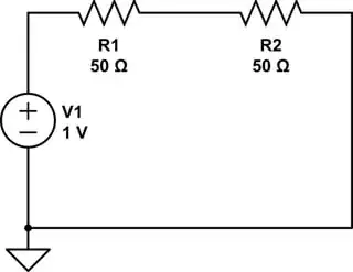

In lumped circuit theory, visual locations of wires in the circuit diagram doesn't matter, the "wires" are not physical objects, but just a way to say "located at", "equal to", "is the same node as".
To describe connections in a circuit schematic diagram in a computer, lumped circuit theory is usually formulated in terms of netlist and nodes. If you draw a schematic diagram on a computer, internally, the CAD represents this circuit using a language called the "netlist" - which is the list of connections between nodes. If two resistors are connected in series with a voltage source, in this schematic:
schematic
In a netlist, each "terminal" is a node, and a node is the most basic object of any calculation in the software. In software, the netlist would be written as something like this:
  1. The right terminal of the voltage source is connected to the left terminal of resistor R1.
  2. The right terminal of R1 is connected to the left terminal of R2
  3. The right terminal of R2 is connected to the left terminal of the voltage source.
  4. The left terminal of the voltage source is the ground reference.
This is the SPICE netlist for this circuit, in computer language:
V1 _net0     0  DC   1
R1 _net0 _net1      50
R2 _net1     0      50
.control exit .endc
.END
As we can see, the only purpose of a wire is declaring the relationships between nodes. A wire plays the same role of an "equal sign" in algebra.
