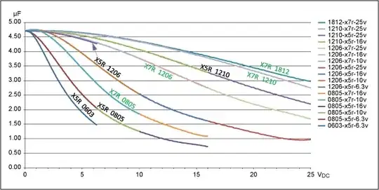

Note capacitance of MLCCs depends on electric field, which can be approximated by DC voltage divided by the physical volume of the capacitor:
Now suppose you use 22µF 25V capacitors both on the input and output to avoid buying 22µF 6.3V separately for the output.
The actual value of the 22µF capacitor on the input, when biased at 12V DC, will probably be closer to 10µF. But the actual value of the 22µF caps on the output, when biased at 3.3V DC, will be much closer to 22µF.
Now if you think "OK I'll put 0805 cap on the input, but output voltage is lower, only 3V3, so I can use 0402 22µF 6V3 caps" then the much higher field strength in the physically smaller cap means its capacitance is reduced, and although it has lower ESL due to its smaller size, the result is increased ripple due to lower capacitance. So if you shrink the caps, you may end up having to put more of them to get back to the same µF value, which means the smaller caps doesn't end up cheaper than the larger one!
If this is for a hobby project, just get a strip of 100x 10µF 25V 0805 so you get quantity discount, put two on the input and four on the output.
