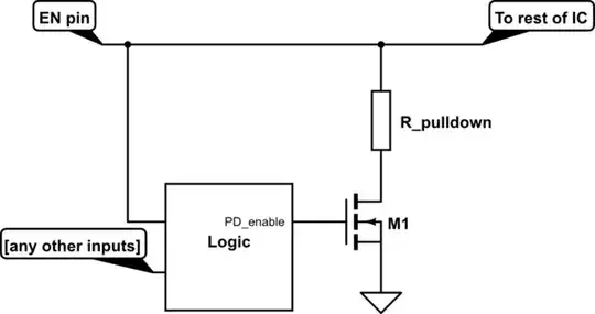

First off, a disclaimer: I'm no IC designer, so there may be some pitfall that prevents this from working inside an IC. But this is how I'd do it on a PCB with discrete elements, if I had cause to.
It's pretty simple, really:
schematic
The resistor can be omitted on an IC, where you can control the size of M1. Just make it have a sufficiently low W/L ratio and its own on-resistance can serve as the pulldown resistor.
If you want the pulldown to be enabled when the chip doesn't even have power yet, it's slightly more involved, but it boils down to just using a depletion mode transistor for M1.
The required logic can be as low-power as you want; static CMOS logic doesn't need much power (doesn't need any power in the ideal case, when it's not switching).
