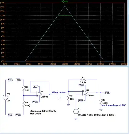

For something like a rail splitter to power an amplifier you shouldn't need to worry about accuracy too much, one problem you might run into though if you're also using a an LM741 (or other non-rail-to-rail op amp) for the amplifier is how close to the positive rail your output signal will be. You want 0 to 10 V, the positive rail is going to be 12 V, so that's only 2 V headroom and with an LM741 that might get you into clipping.
Since your output will only be going down to 0 V you can sacrifice some of the negative headroom for more positive headroom by making your voltage splitter output voltage be something like 9 V. Now you'll basically have a +15 V / -9 V supply and you'll have 5 V between your max output signal and the positive rail.
Here's an example of that, I don't have the LM741 model so I used LT1001. The rail splitter bottom resistor is stepped from 15k giving \$\pm\$12 V to 9k giving \$\displaystyle +\$12 V \ \$\displaystyle -\$9 V. The input to the \$\times\$3 amplifier is a 4 V triangle pulse (to exaggerate the clipping as an example), with an even rail split it clips at 11 V, with the uneven rail split it allows the full output of 13.3 V.
offset rail splitter

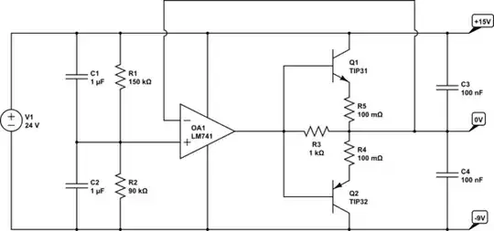

If you need the virtual ground to handle more current than the op-amp is capable of, for a 741 maybe 25 mA, you can add a simple transistor buffer. Something like this should get you at least a couple of hundred milliamps.
schematic

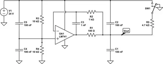

The 741 is well within supply voltage limits and can be used to make a rail splitter.
schematic
Above is a simulation of such a circuit with a load switched from -2.5mA to +2.5mA and it is reasonably stable. Obviously your 24V supply must be floating wrt where the pseudo ground is connected or you'll just short it out, if one side of it is grounded to the PLC input you'll have to do something else like regulate the 24V down to 12 or 15V if necessary and use a DC-DC converter to get negative voltage (or use a single supply op-amp circuit and trash the 741s entirely - hint hint).
The amplifier 741 should be okay too- it is guaranteed to swing to +10 with a 12V supply provided the PLC input does not present a load of less than 10kΩ.
Of course a better op-amp would be preferable.
