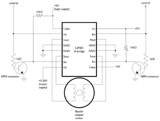

Like this sheet on how to connect a bipolar step to its driver and to the arduino: enter image description here
It's a nice blueprint to use for a beginner on how to connect the different pieces together. Do you make your own version of that for a piece you are adding before actually start soldering and connecting it?

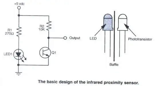

In a general case, if you want to use the sensor as, well, a sensor for the Arduino to act on, you would need to connect it like this:
This gives an inverted logic. When the Transistor (in the sensor) is off, not conducting, the Output is held HIGH because of R2. When the sensor sees IR from the led, it starts conducting, and Output starts to go low. The output would be connected to a analog in pin on the Arduino. You would read the state of the pin, and based on your code, do X if the Pin is Y or under Y or Over Y or between Y and Z, etc.

Its a nice blueprint to use for a beginner on how to connect the different pieces together. Do you make your own version of that for a piece you are adding before actually start soldering and connecting it?
Yes, definitely. Always do a circuit diagram or schematic before building a design, even if it's just a quick sketch in pencil on the back of an envelope. There are circuit diagram creation programs, but they don't really provide any assistance to beginners. (There will be lots of design assistance features in the higher end programs, but you have to know what they mean).
As to where the design itself comes from, the circuit diagrams in datasheets are a good starting point. There will also be manufacturer "reference designs" or "app notes", some of which you can just implement directly or with small modifications or accessories.
